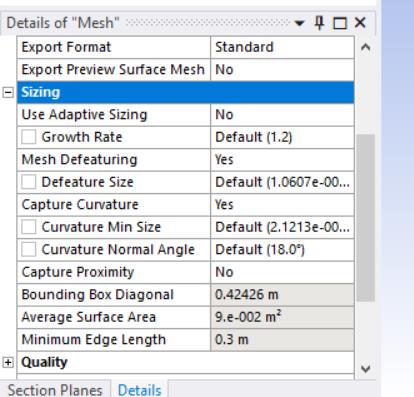

      Can you please insert a picture of the mesh and the mesh details?
    • Shiv1510
      Mesh
      mesh details
      Yes here it is
