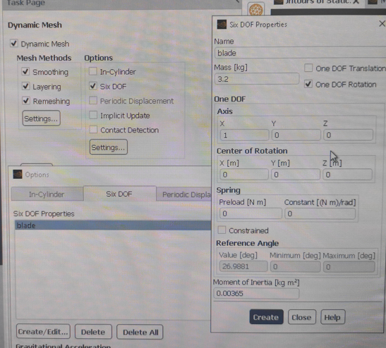

Earlier I solved a test problem with wheel rotation.
/forum/forums/topic/connecting-the-wheel-into-one-piece-fluent/
/forum/forums/topic/the-pump-wheel-does-not-rotate-in-the-fluent-dynamic-grid/
She made a successful decision. Changed weight and inertia..

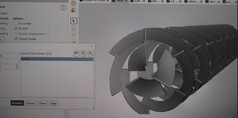

Now I enlarged the wheel, made it longer, and added paddles inside and out.
All settings are the same.

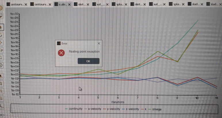

But the task started to give an error:
I can't find a priic because I tried everything:

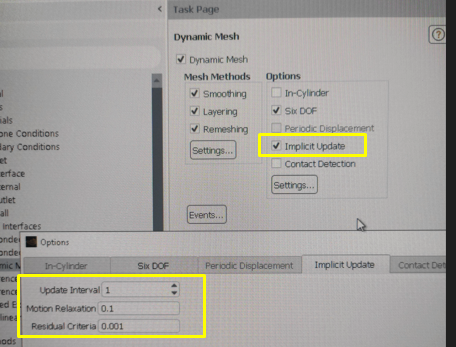

1.I included implicit in 6DOF
2.I refined the grid to 10 million cells, although the single wheel version contained only 800k.
3.I tried all methods (coupled, simple, piso).
4.I also reduced the time steps and added a lot of sub steps.
Nothing helps.

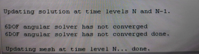

During the solution, I noticed that the following error would appear in the console:

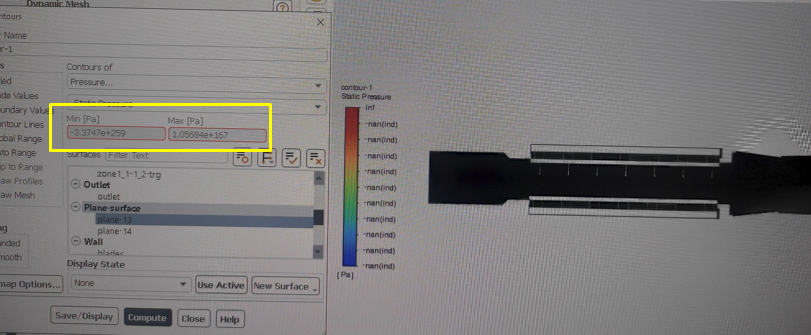

In addition, after the error I checked the pressure:
I carefully checked all the boundary conditions, they are all set in the norm, at the inlet the flow rate is 2.9 l / s, at the outlet the pressure is 12 MPa, 5 inputs from above at 4 MPa. The liquid to be transferred is water.
What could be the reason? Thank you.

Forum ModeratorI'm assuming the screw is inside a pipe, and that it's not touching the sides? Do the blades interact with anything else or is it a standard Archimedies screw?Â
August 31, 2023 at 4:35 pm
javat33489
SubscriberNo, the screws do not touch the walls, only with water.
I solved the problem after 150 tries.
The problem was solved thanks to a very small time step 1e-8. Grid with skewness less than 0.8.
