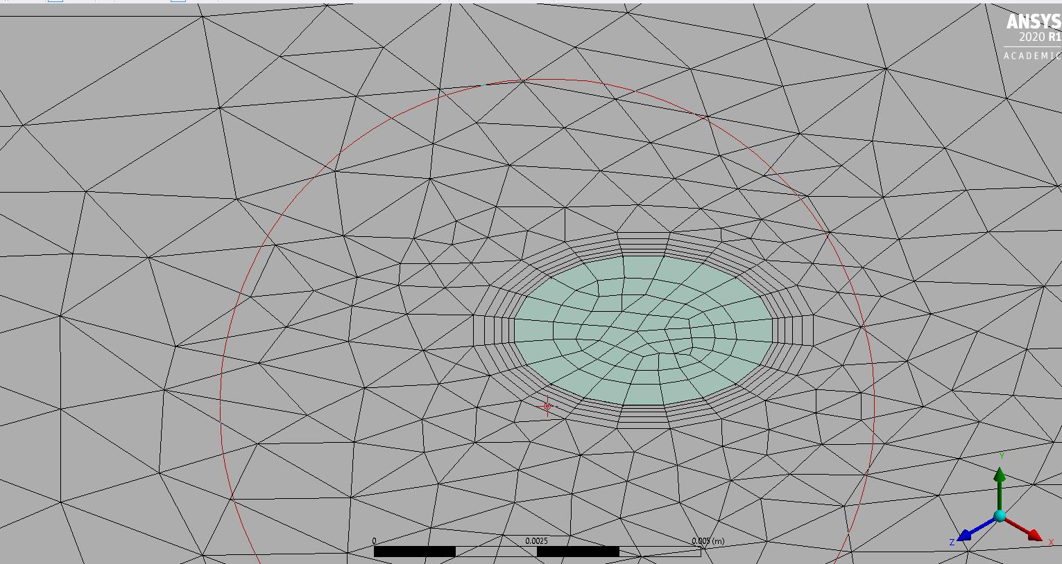

      What's the mesh like around the cylinders?
    • PRABUPETER
      For the meshing around the cylinders, I used both with and without inflation, as shown below.
