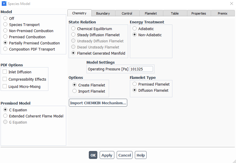

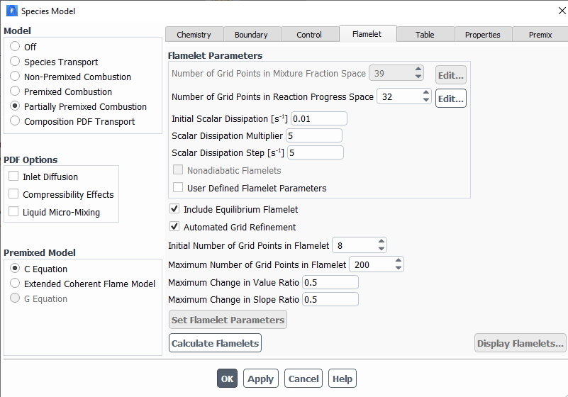

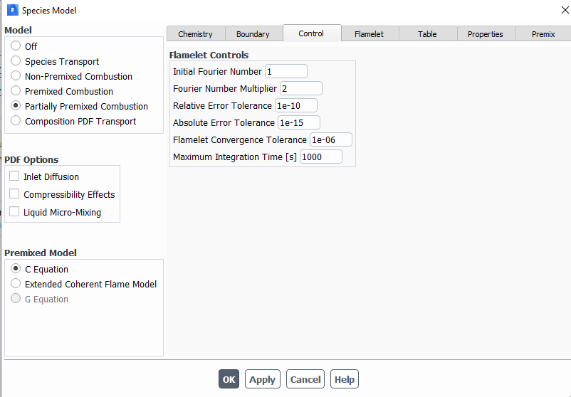

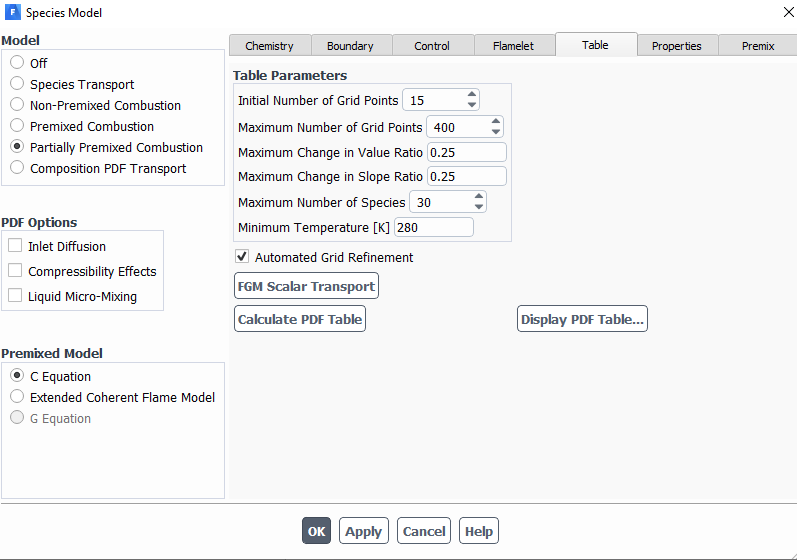

      If it worked steady we're not sure why transient isn't working. Please can you add screen shots of the species & combustion panels.
    • Nick Pester
      Hi Rob,
      Please find below the images.
      Thank you,
      Nick
      That looks fine. Which version of Fluent are you using?

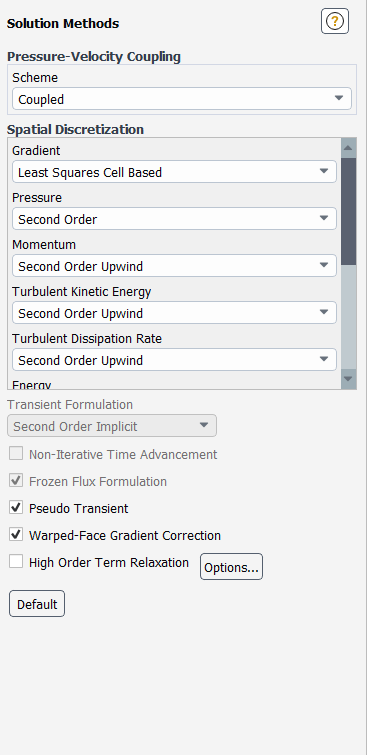

      Some comments from over the weekend. A couple of colleagues have seen an error but it's not repeatable enough to diagnose.
      Try restarting after switching to transient, ie switch over, write case & data. Close Fluent. Open Fluent & load files.
      Double check you have got the time step set correctly. There's a GUI glitch which can void the setting, check the ribbon AND tree menus are seeing the same result.
