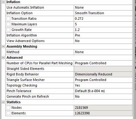

      Hello ANSYS community
      I am trying to simulate the fluid flow over an aircraft but I am constantly getting a float point error despite refining the mesh. I have also tried to group the whole aircraft assembly as a single part, both hybrid and standard initialization but the float point exception still persist.
      Attached are the mesh and set up details for reference and I hope someone could help me out!
      Thank you!

      Look at mesh quality: you've got several flat (very squashed) cells.  Ortho quality should be over about 0.1 and skew below about 0.9-0.95 depending on cell type & flow gradients.

      There are. First off you need to find the cells (click on the graph bars of the poor cells) and work out why they're bad. From there you eliminate the cause.  Sounds simple but it can take some doing.
      Once you've found the poor cells post images and we may be able to offer advice or (much better) comment on your ideas.

      I suspect you've exceeded a face cell limit (there's a cap on the number of facets) if you're now meshing the gaps with sufficient resolution to make the model work.

      It is weird but I could update a mesh with more elements before I duplicated the file to improve on the geometry gaps.
      Attached are the screenshots of the difference in number of elements for your review.
      Figure 1. Original Copy
      Figure 2. Duplicated and Improved Geometry
      Not sure: check size functions and see if you can increase the minimum sizes.

      My apologies for the late reply as I was trying to solve the mesh issue. I have managed to update the mesh after I apply patch independent method to the geometry.
      If that works you've got a sliver face or short edge somewhere. Patch independent just ignores those.
    • Keyur Kanade
      Patch independent is top down approach. It ignores small features automatically. So your geometry must be having small features and that is why patch dependent mesh fails.
      Please note that as you are trying to solve external flow, recommend to cross check if any important geometry features are ignored by patch independent meshing. Then proceed to solver.
