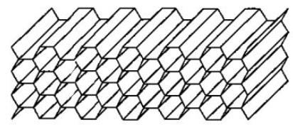

      Note that honeycomb core is an orthotropic material, so you need three values for Young's modulus and three for Shear modulus, rather that just one Young's modulus for an isotropic material.  That also means you have to pay attention to which direction the honeycomb core is assembled into the sandwich so you put the right shear modulus in the right direction that matches the orientation of the geometry in your model.

      OK - it became a bit confusing. Orthotropic properties you would need to give to the honeycomb if you were approximating this structure with a single 3D plate/volume part thus using 3D brick elements, but if you represent the actual honeycomb geometry in 3D then you do not need that (Orthotropic). This can be called homogenisation of properties. See here for details for this
      https://paginas.fe.up.pt/comptest2006/proc/files/abstracts/comptest06_61.pdf
      So for using the actual honeycomb geometry (shell geometry)
      The skins and your core are made of isotropic aluminium which you can find the Young's modulus on say mat-web or from the manufacturer (say something like ~ 73 GPa). Density you have (~2800 kg/m3), so that is all you need, with Poisson's. Thickness as shown in the tutorial you can assign to the surface parts.
      Use also appropriate connection between them (Say bonded contact or something reasonable).
      @Akshaykumar717,
      As jj77 says, there are two ways to build an FEA model of a honeycomb core sandwich composite panel.
      I used a solid block and assigned orthotropic properties to represent the behavior of the core without having actual hexagonal cells.  This is an efficient way to model the panel.
      The other method is to model the actual honecomb cells made of isotropic aluminum foil in hexagonal (not octagonal) shape.
      Note that the wall is double thickness on 2 sides and single thickness on 4 sides.
      Please reply and clarify which approach you are taking.

      2. Please insert an image of the honeycomb structure into your reply.  Is it a solid brick that uses orthotropic properties or actual hexagonal walls? It's not clear what you did.

      2.68 g/cm^3 = 2680 kg/m^3 which is the density of solid aluminum.
      That is not the density of the honeycomb core as configured between the skins.
      The volume of the core is mostly air.
      What is the cell size for your honeycomb core?  For each cell size, there are a range of densities that depend on the ribbon thickness.
      Let's say it is the 1/4 inch cell size at 5.2 lb/ft^3 = 83 kg/m^3 which is only 3% of the density of solid aluminum.
      Now do you see the three columns labeled modulus in the table above?  Those are the values you use in the orthotropic material.
