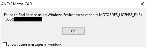

    • CapstoneA
      Hello All,
      I was able to resolve the above issues by doing the following:
      1. I copied over the 'ansyslmd.exe' file from 'C:Program FilesANSYS IncShared FilesLicensingwinx64' into the same folder where the 'lmgrd.exe' file is located in the download package (where 'lmtools.exe' is launched).
      2. I created new firewall exceptions for the following programs: 'lmgrd.exe', 'ansyslmd.exe', 'ansysli_server.exe', 'ansysli_monitor.exe' and 'ansysli_client.exe'.
      However,
      Now, when I launch MotorCAD, I get the following errors (images 4 and 5):
      Any suggestions?
    • Clara Picoron
      Hi Array I’m sure this has long since been resolved but I’ll offer a possible explanation anyhow in case it comes up again.nnRegarding License Manager (LM) server specification:nMOTORDES_LICENSE_FILE environement variable has been deprecated, it has been replaced by ANSYSLMD_LICENSE_FILE. Value is the same 1055@lic_server_name_or_IPnLicense Server specification is also saved under ..\ANSYS_Motor-CAD\Shared Files\Licensing\ansyslmd.ini file with this line: Server=1055@lic_server_name_or_IPnnRegarding LM operations:nError message indicates that the vendor daemon (ansyslmd) is not started. To resolve this open ANSYS License Management Center on click on STOP until the three component are in 'not runing' state:nLicensing Interconnect: not running nLicensing Interconnect Monitor: not running nFlexNet Licensing: not running nThen check in Task Manager that none of these process are running anymore (ansysli_server.exe, ansysli_monitor.exe, ansyslmd.exe and lmgrd.exe) if they do, kill them. Then click on START in the ANSYS License Management CenternnI hope this help.
