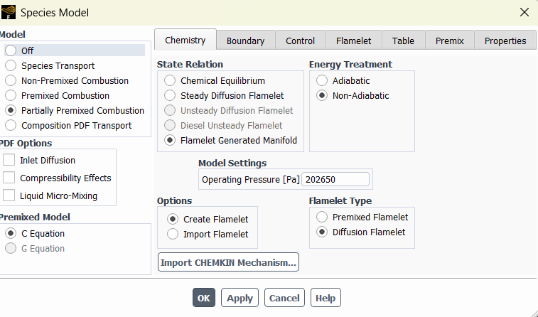

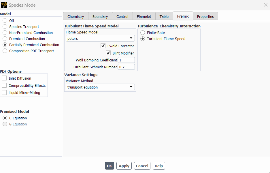

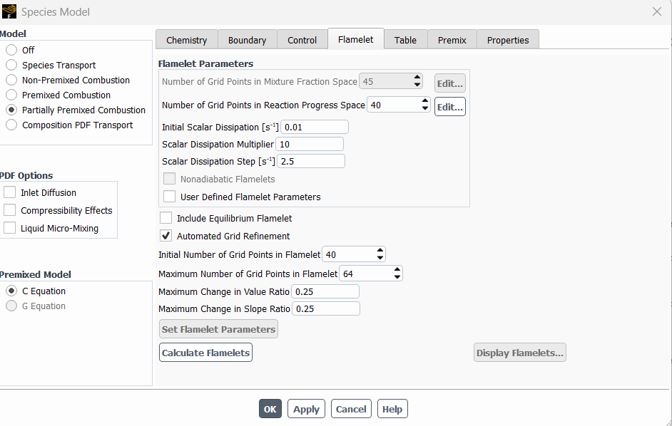

    • Ren

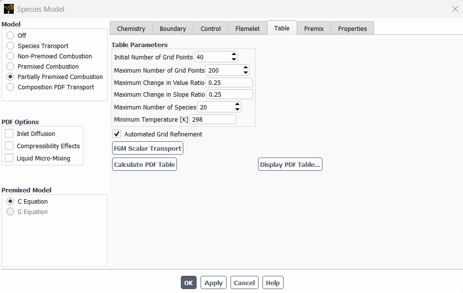

      If you could send me the details of the model setup then I can do some investigation. Specifically, please provide:
      Screenshots of all tabs of the "Species Model" dialog box.
      what are the fuel and oxidizer
      What chemical mechanism is used.
    • m.d.lasica
      Thanks.
      These are screenshots:

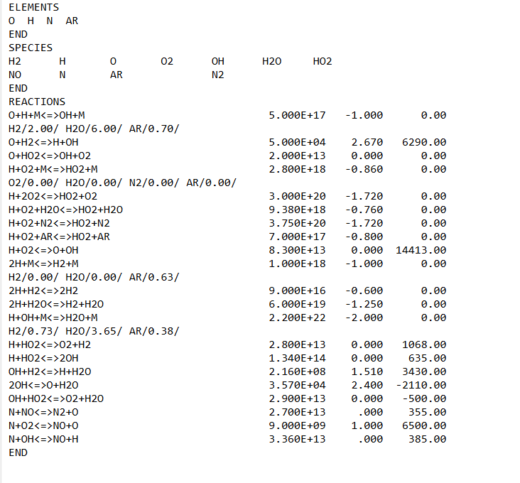

      Fuel is 100% Hydrogen, Oxidixer is air.
      Chemical mechanisms is DRM19 without hydrocarbons with added Zeldovich thermal NO equations.
      Thermo and Transport data are from GRI3.0

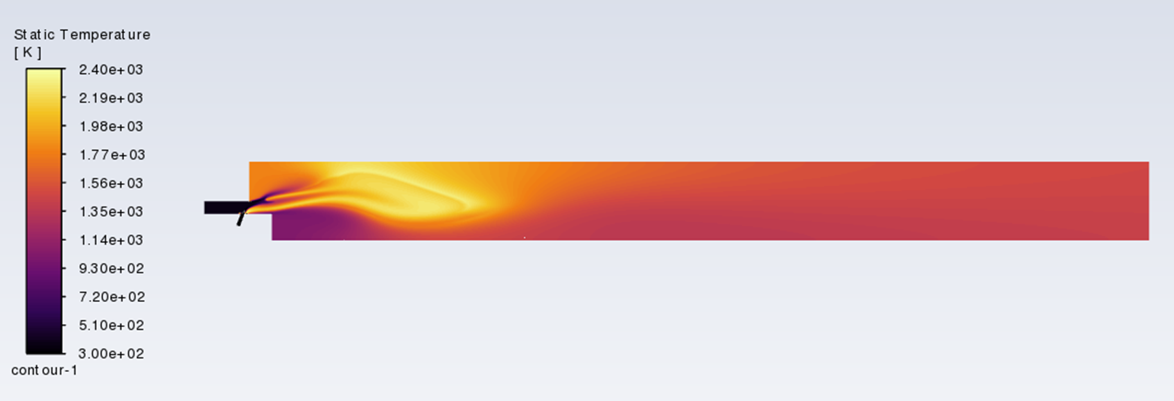

      Could you show me a temperature contour plot with global range on?
    • m.d.lasica
      Yes, sure. This is temperature field:
      It's quite similar to that I get from EDC.

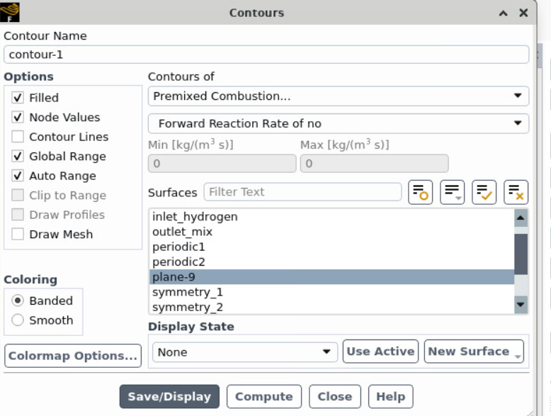

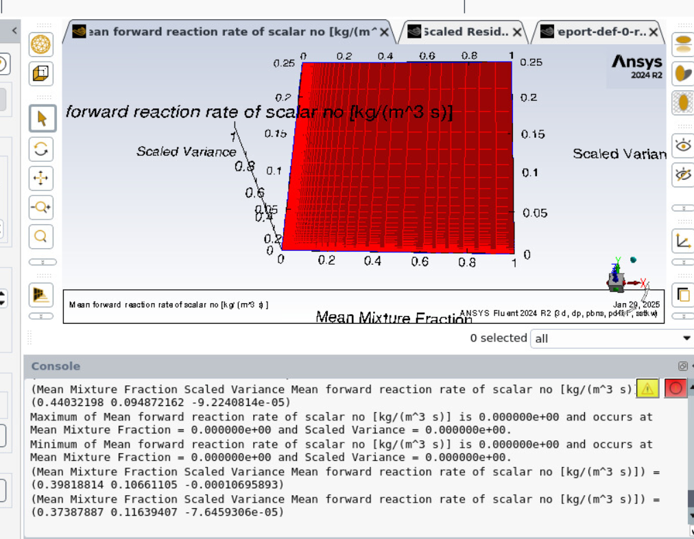

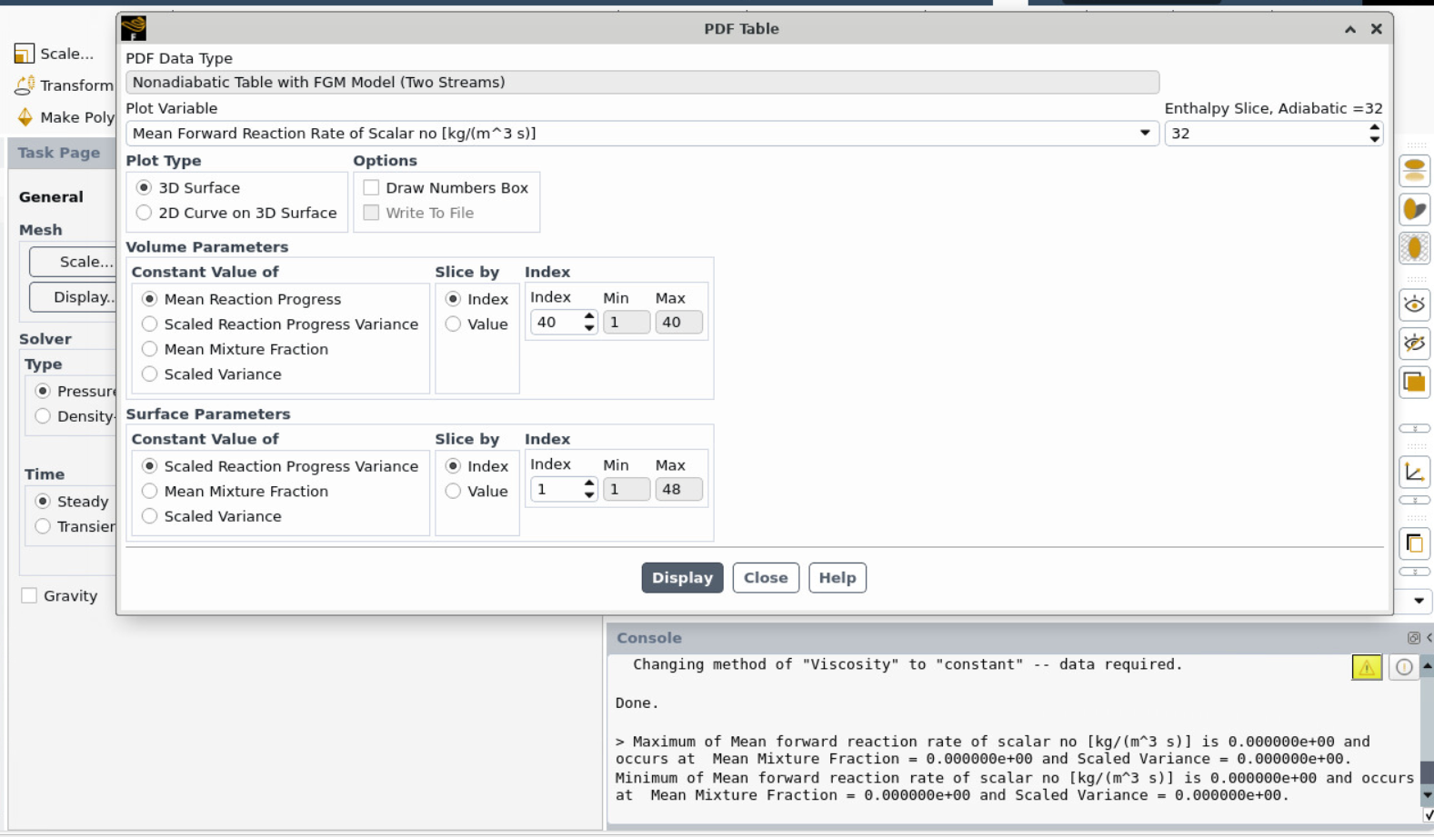

      There is one more thing I wanted to mention. I was reviewing the results again and noticed that both the forward and backward reaction rates of NO are zero.
      I went back to the PDF table, and when I attempted to display it for any combination of controlling parameters, the TUI output showed that the maximum and minimum reaction rates were both zero. However, when I clicked on the values displayed in the table, they appeared to be non-zero.
      Do you have any insights into why this might be happening?
    • m.d.lasica
      I encountered the same issue in my case using GRI3.0. The values of the transported species are all zero. I also examined the PDF table, and both the forward and backward reaction rates are zero. This suggests that the issue lies within the PDF table, but I’m unsure why this happens only in my case. Could you share a screenshot of the reaction rates for NO from your PDF table?
      Thanks in advance!

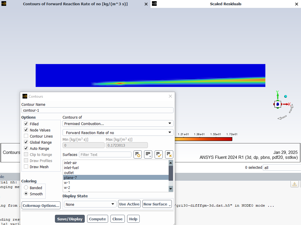

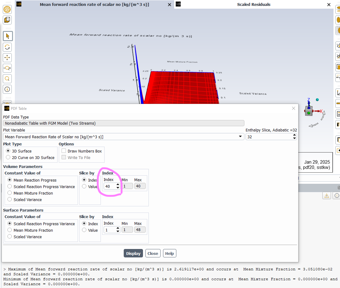

    • Ren
      I did not do anything extra other than activating the no and co FGM scalars.
      This is a screenshot of the no forward rate contour plot:
      This is a screenshot of the PDF plot and please note that I set the mean reaction progress index to the burnt state (40):
    • m.d.lasica
      Thank you.
      I checked the same slice of the PDF table that you uploaded, but unfortunately, the reaction rate is still 0 in my case.
      Do you have any idea how I can fix this? What can I do? I would greatly appreciate any suggestions.
    • Ren
      Hi, I can't think of anything that might be the cause. Could you try again from scratch (using a mesh file) using the gri3.0 mechanism?
    • m.d.lasica
      I set up the simulation from scratch using only the mesh file. First, I used GRI3.0 and obtained satisfying results. Then, I switched to my mechanism and also achieved positive outcomes. The simplest method turned out to be the most effective. Apparently, the issue occurred when I switched from volumetric to partially premixed combustion while working on the previous case file. Thank you for your help!

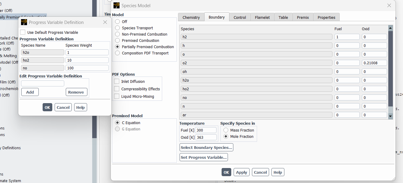

      I have one more question related to flamelet generation and the progress variable. Ultimately, I plan to compute flamelets using external software and upload them to Ansys Fluent with an optimized progress variable. In the Boundary tab, there is an option to define the progress variable. I generated flamelets for three different progress variables and examined the saved files. While the flamelet data changes as expected, the "reaction progress" remains unaffected.
      Could you clarify what reaction progress represents and how it is calculated? It does not seem to respond to modifications in the progress variable.
      Thank you in advance!
    • Ren
      The reaction progress is the normalized progress variable as defined in Eqn (8-107) of the theory guide. It has values between 0 and 1 regardless of the definition of the progress variable.
      For postprocessing, both the normalized and the un-normanlized progress variable are available.
