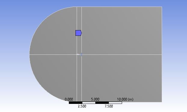

      Hello
      It seems the mesh around the airfoil I generated has a high aspect ratio and has poor quality elements
      There are regions close to the airfoil wall where the mesh just becomes unstructured as shown below:

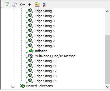

      The mesh was created using edge sizing with biases towards the airfoil wall, one of them shown below:
      The Mesh controls utilized are shown below:
      inflation was created to help capture the effects of the boundary layer.

      You may find it better to remove the vertical trailing edge from the inflation definition.
    • Keyur Kanade
      as peter mentioned, please improve selection.
      also please go through following and try to create that mesh.
      please follow
      https://confluence.cornell.edu/display/SIMULATION/FLUENT+-+Flow+over+an+Airfoil
