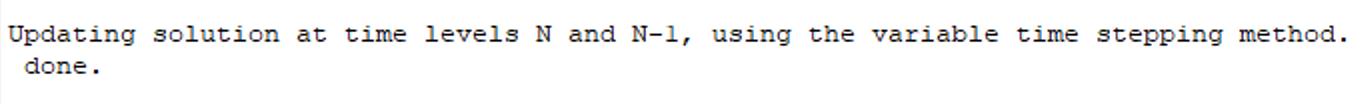

      Thank you. I have selected the fixed time stepping in the "run calculation" section but the output says that it is updating the solution at time N and N-1 using variable time stepping method. Should I try to start the case from scratch?
    • DrAmine
      Variable time stepping is an adaptive approach used for multiphase modeling. This will adapt the time step based on global CFL number near the free surface cells.

      I've done it again from scratch and it is still using the variable time stepping method despite saying fixed time stepping method in the run calculation panel. I am using the pressure based solver

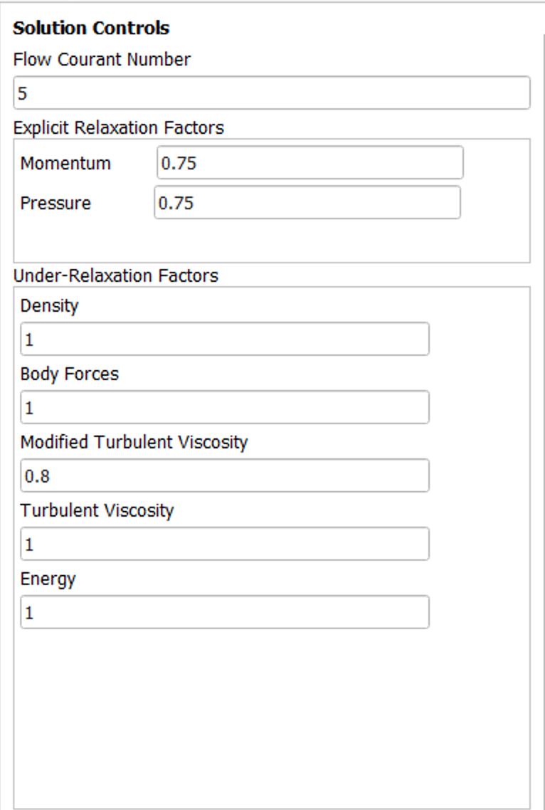

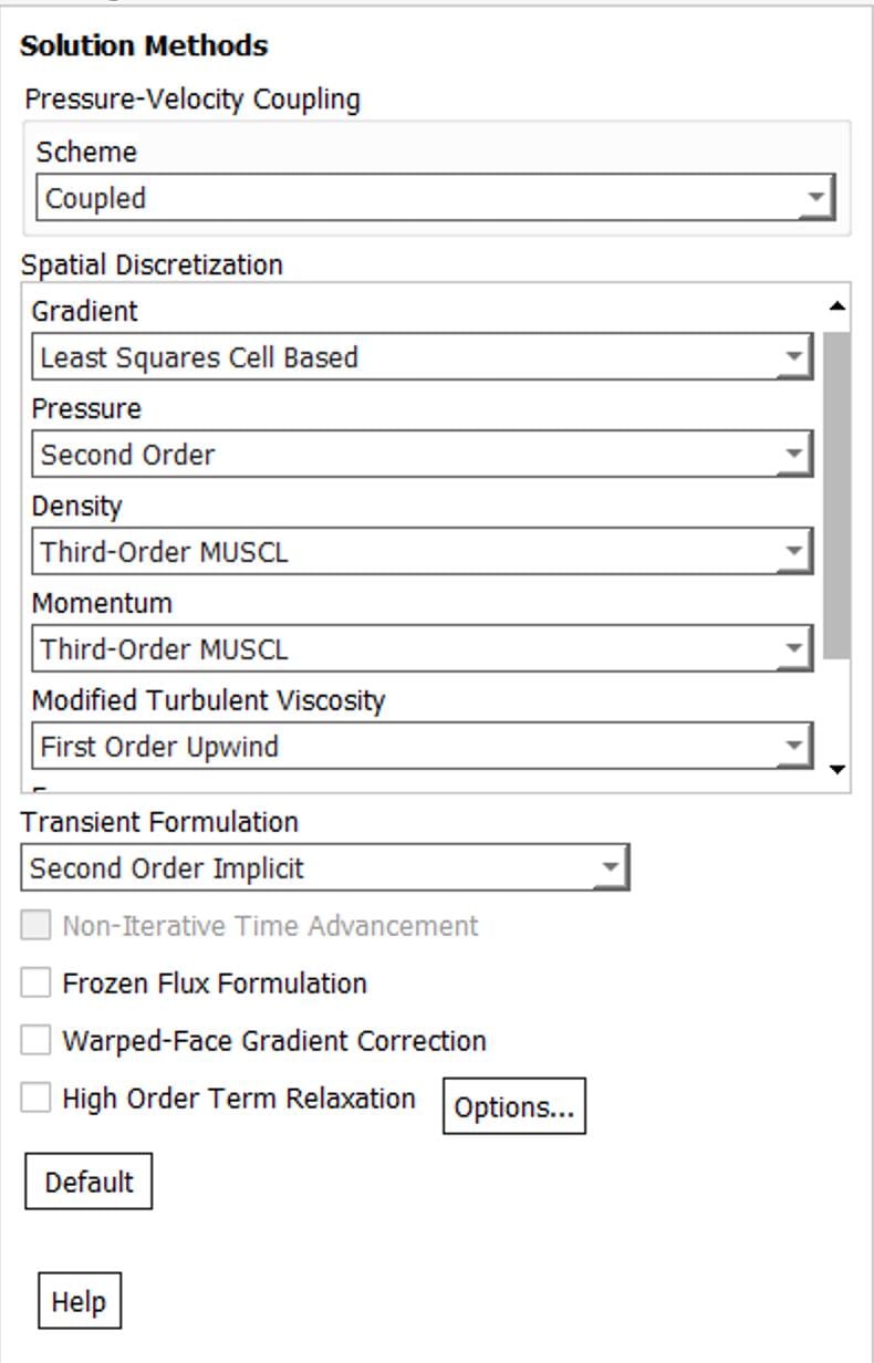

      Share screenshot of Solution Methods and Controls. Which version are you using? What do you mean from scratch?
    • kmkb21
      Thank you.
      I am using version 19.2 (Installed a couple weeks ago). I reimported the grid, set the turbulence model, chose the transient option, pressure-based solver, then edited the materials, cell zone conditions and boundary conditions, changed the methods and controls, intialized the flow (standard initialization computed from the farfield values), and ran the calculation. I can share the case if desired, as well as a case which is the same but with twice as coarse a grid.

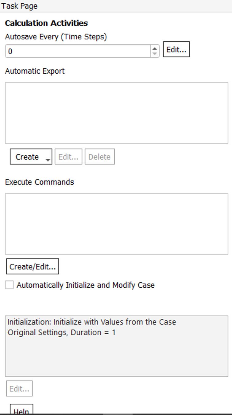

      Please add a screenshot of the Task page where Calculation activities are listed. Are you using any scheme command? If you now save the case file into .cas and open it in Notepad++ and search for "variable" and "variable time" where do you find them?
    • kmkb21
      Please see the screenshot attached. In the initial .cas file, the model was set to laminar, though once I extracted a new cas.gz that I saved, these were the results for searching for variable:

      Variable time step is not activated according to the settings. I cannot say now why the message is written.

      Regarding your question here: I can reproduce the message and it is just referring to the method deployed for discretization. You do not worry about that. Your time step is fixed.
