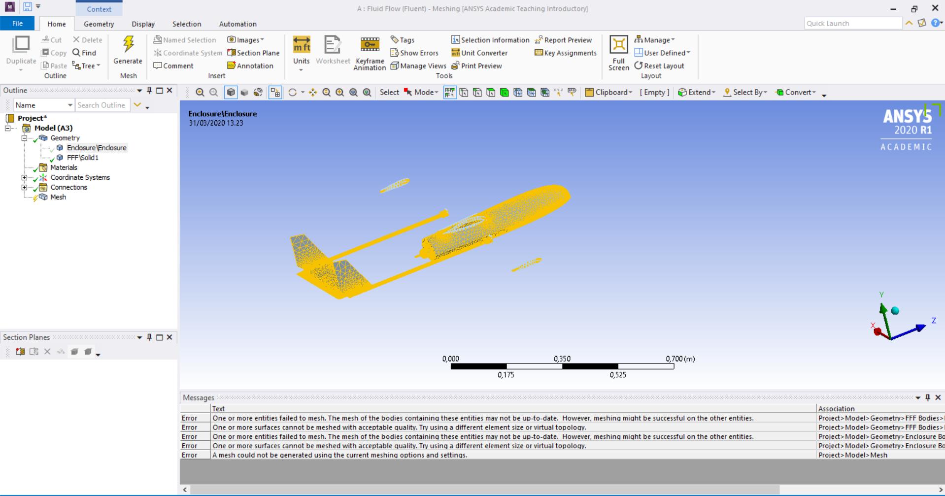

excuse me, and thank you for the response of my discussion earlier and it was very helpful. However, I have a new problem when I finish meshing. the mesh that I did was not successful, 5 errors appeared after running the meshing. (I have done a geometry check, and there is no error). How to fix it?

Forum ModeratorIf you're looking at the airflow do you need to mesh the inside of the aeroplane/drone? If not, suppress the body and try again. Also read the messages and have a look at the mesh size settings.Â
April 1, 2020 at 3:01 am
Keyur Kanade
Ansys Employeeit looks like you have very coarse mesh at some small features. please use edge or face sizing.Â
also it may increase cell count. so you can take advantage of symmetry. please slice the model in half and use only half to mesh.Â

April 1, 2020 at 3:32 am
IrfanPeratama
Subscriberis this, need enclosure before meshing? i saw on your vidoes i dont see of enclosure
April 1, 2020 at 7:09 am
Keyur Kanade
Ansys Employeeif you are doing fluid flow then you need enclosure before meshing.Â
you need to mesh fluid volume around your airplane.Â

April 1, 2020 at 10:13 am
IrfanPeratama
Subscriberi do enclosure to my geometry before meshing. But, the result for meshing have an error like on the picture i post. and i dont know how i can fix it for the error. cause im not familiar about this software, im just start using this software a couple days ago... sorry for my language sir, if im wrong.
