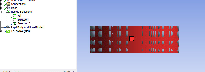

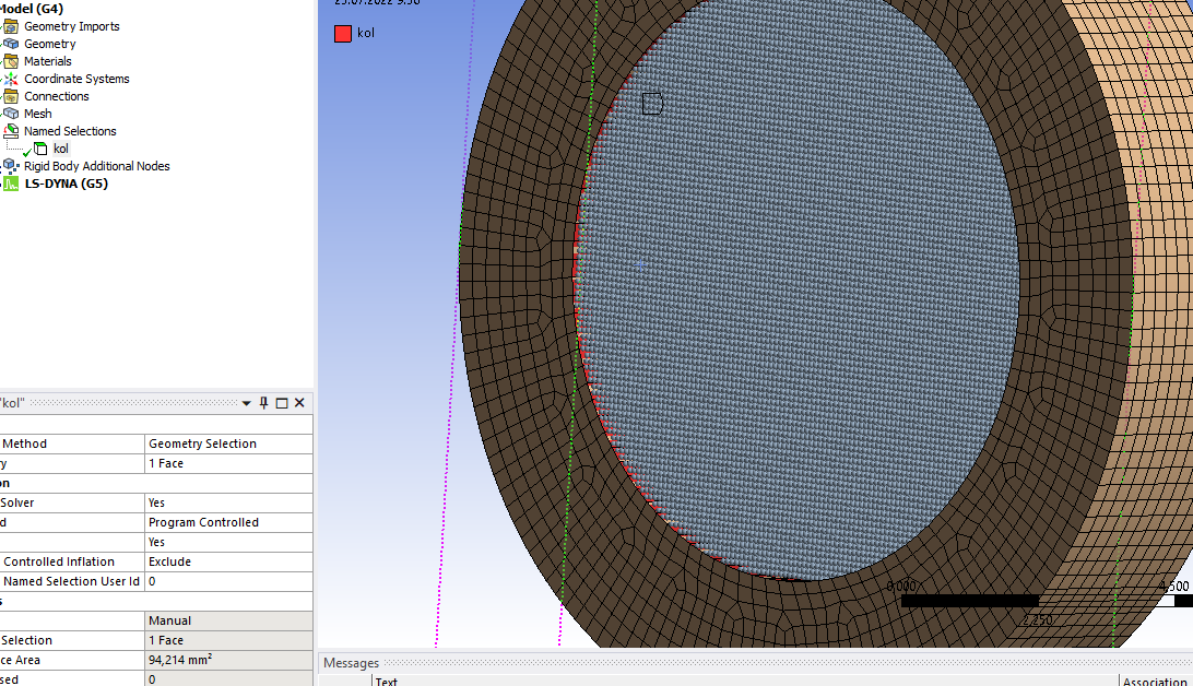

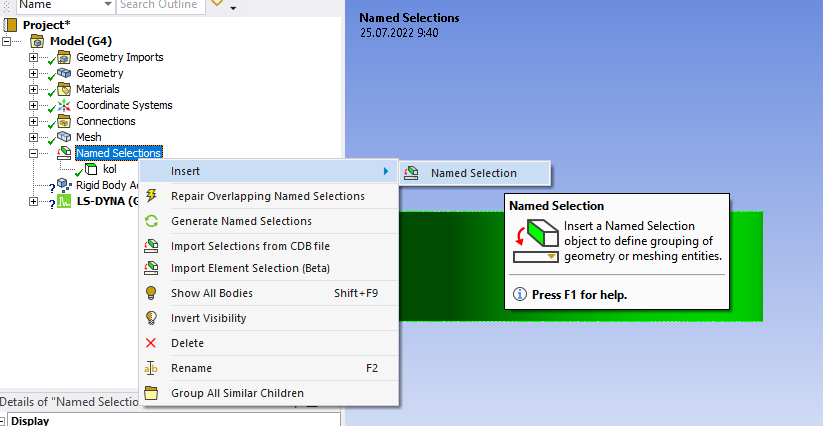

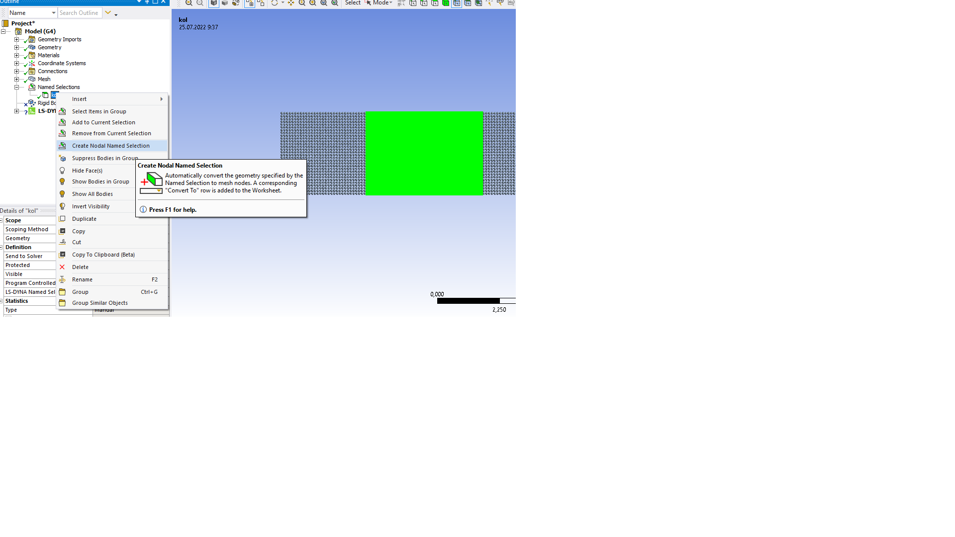

To have a very solid connection between your SPH body and the rigid body, you could use "Rigid Body Additional Nodes" (*CONSTRAINED_EXTRA_NODES) to connect (add) certain nodes (really SPH particles here) to the rigid body. First, you will have to create a Named Selection of the nodes (SPH particles) you want to connect:
And then, use this nodal named selection in the "Rigid Body Additional Nodes" object:
The body in blue in the image above is the rigid body.
Reno.

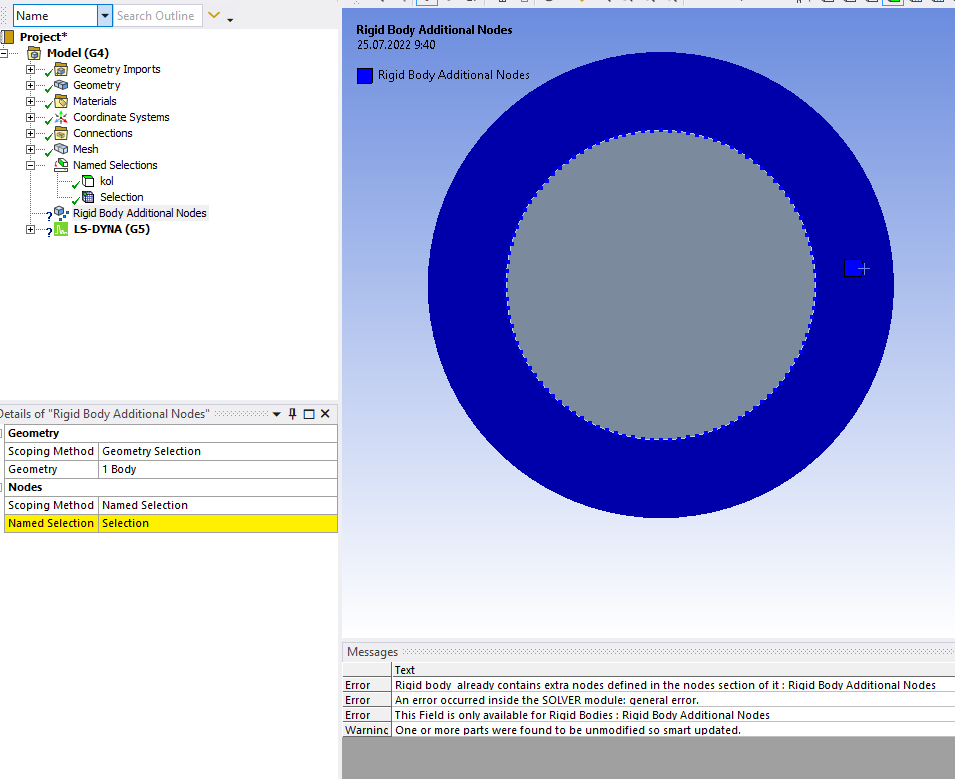

July 25, 2022 at 6:37 pm
July 25, 2022 at 6:39 pm
July 25, 2022 at 10:02 pm

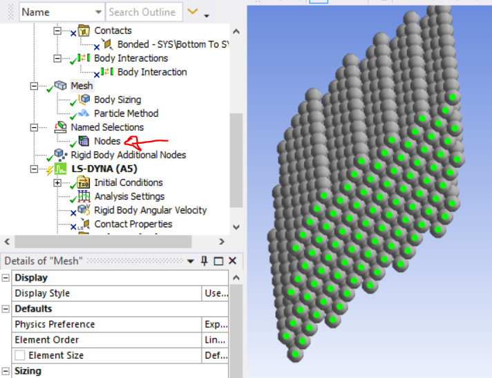

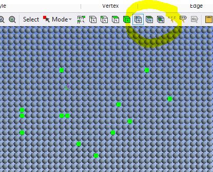

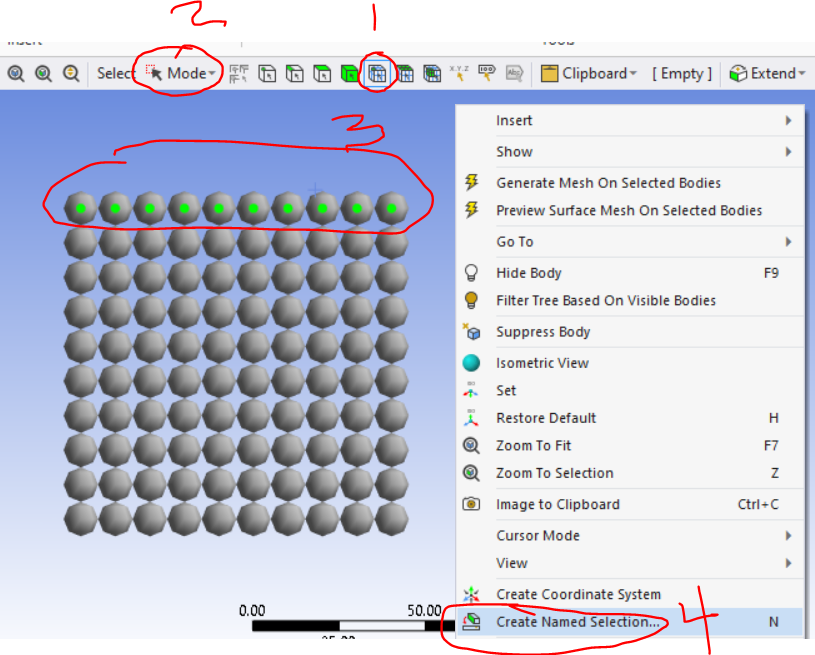

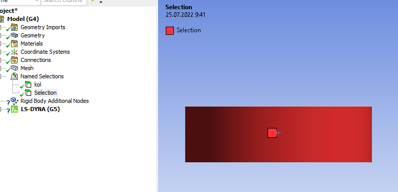

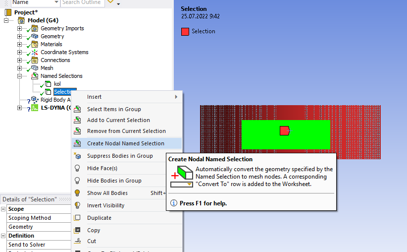

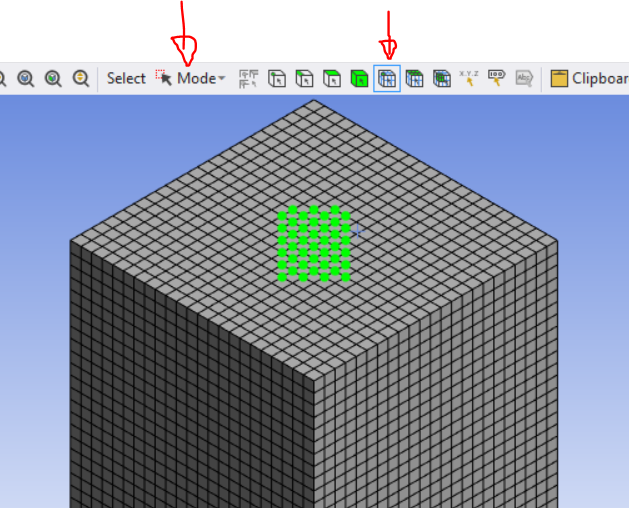

Ok, you're right; the first method above does not work for SPH particles; you cannot create a named selection from a face and then convert it to nodal named selection. But, you can select the SPH particles directly using the node selection tool and create a named selection:
- Select nodes.
- Right click in the display window and choose "Create Named Selection:
Reno.

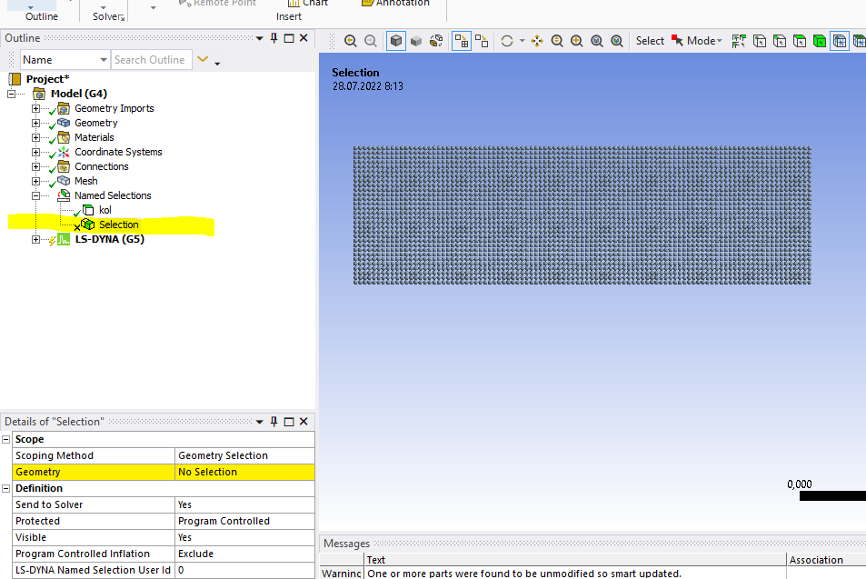

July 28, 2022 at 6:07 pm
August 11, 2022 at 12:41 pm
javat33489
SubscriberWhat to do next sir? Does not help.
