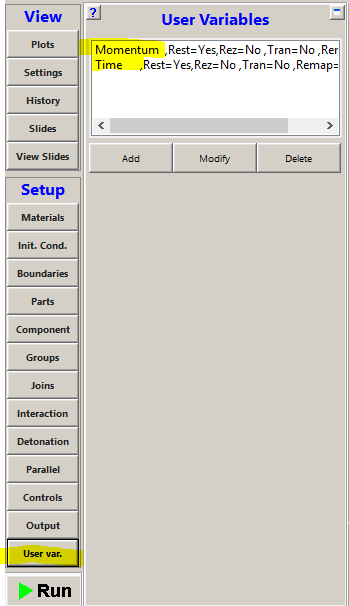

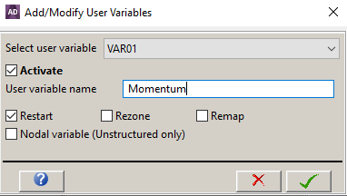

      The user subroutine EXEDIT3 in the Autodyn User Subroutine Tutorial uses VAR01 and VAR02 to store the maximum momentum calculated by the user subroutine and its associated time.
      To plot VAR01 & VAR02 in Autodyn GUI using Contour Plot or set them as Time History variables for History Plot, you need to activate these two variables in Autodyn GUI before running the model.
      You need to click on User Variables at the left navigational bar in Autodyn GUI to Add and Activate the variables VAR01 & VAR02. Make sure Restart is checked so these variables are stored for restart analysis. See attached picture below.

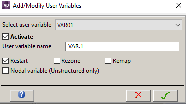

      You can also rename the variable, for example, VAR.1 to Momentum. See attached picture below. Thus, for plotting purpose, Autodyn will show its name as Momentum in Contour Plot and Time History Plot. However, internally the name doesn't change so you still need to refer it to VAR01 in the user subroutine.

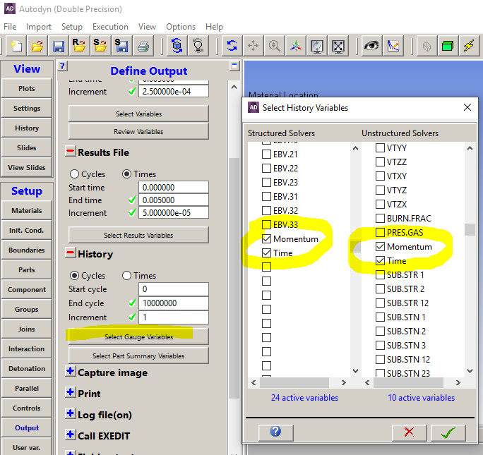

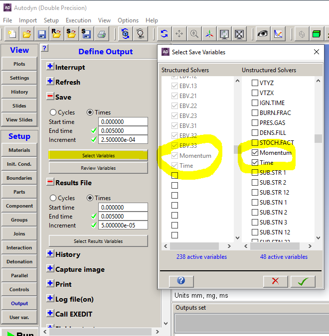

    • Chris Quan
      The user subroutine EXEDIT3 in the Tutorial is created for Lagrange parts, not for other parts such as SPH particles.
      Make sure the variables VAR01 & VAR02 are selected in Output. See attached pictures below:

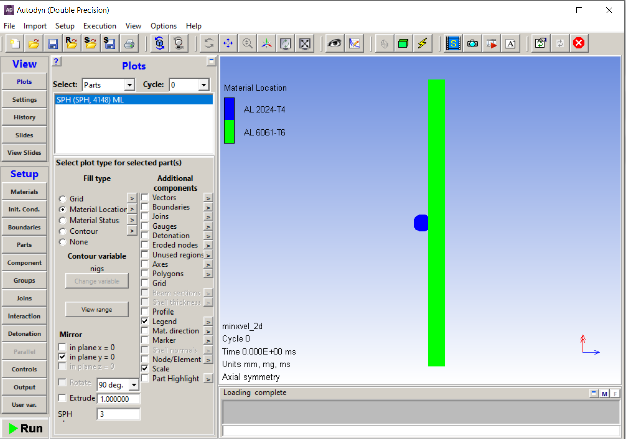

      I have modified the EXEDIT example subroutine to find minimum X-velocity of the particles. I would like to extract the negative values of all the cells which have a negative x-velocity. In picture 2, this is all the particles which move in the left direction. The contouring is in x-velocity. I have tried to create a file called mytable.txt which writes this data so that I can see it, but I can't seem to figure out where to put it in the code. Eventually I would also like to add cell mass so that I can extract each node's x-momentum. Any help would be greatly appreciated. Thanks.
