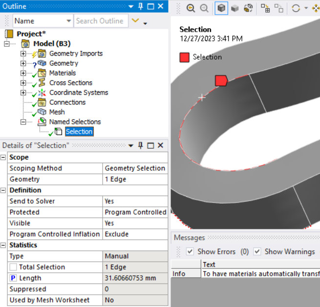

      I am currently working with ANSYS Mechanical and have defined a line using named selection on a curved surface, as shown in the figure below.
      Now, I need to measure the length of this line after the simulation. While I can measure the deformation, ANSYS provides me with the deformation of "each node" on this line in "three directions". Therefore, it is not possible to use directional deformation values to determine the new length of the curved line.
      I have located the initial length of the line in the named selection section before simulation. However, there seems to be no option for the new length after the simulation.
      I aim to conduct a parametric study and output the length of the line as a result. I would greatly appreciate it if someone could assist me in finding a way to define the new length as an output using Python output code (in ansys mechanical), APDL command, or ANSYS Mechanical settings.

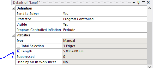

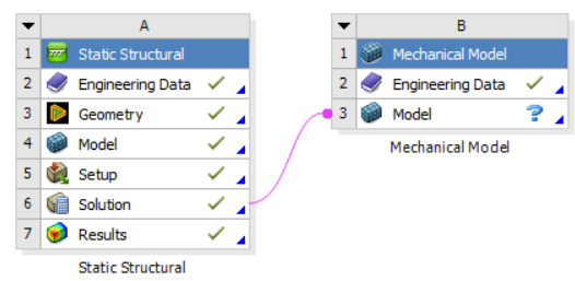

      Instead I can offer a simpler method. Transfer Solution to Model cell of a deformed system.
      In the downstream system, you can create a named selection of the edge and promote the length to a parameter in the details of the named selection:

        Additionally, I have implemented your suggestion using the Mechanical Model. It is helpful, and I have obtained an answer for my current simulation. However, I have a question: each time I define a new parameter for geometry as an input and update the solution, ANSYS cannot define the named selection line in the Mechanical Model. Have you ever tested this? Do you have any suggestions to resolve it? I mean, you can change one parameter in Static Structural, update the solution, and then go to the Mechanical Model. You will find that the named selection in the Mechanical Model is undefined.

      I see that the named selection cannot generate in the downstream model. That's because the geometry gets synthesized from the mesh after each update, so geometry IDs can be different each time. I would think you could create the named selection in the upstream analysis, but it appears that only face named selections are transferring to the downstream analysis, not edge named selections (I tested in 2023 R2).
