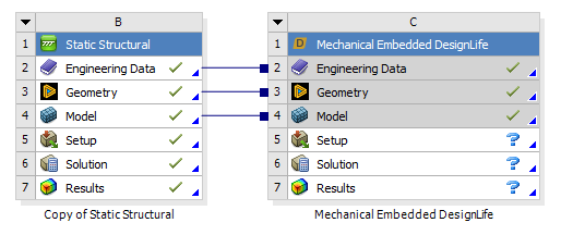

      Hi! I'm implementing a custom ACT solver for the ACT extension I am developing in Ansys Mechanical during my Ph.D. My custom ACT solver connects to a Static Structural system (just like nCode DesignLife, see image below) and implements a custom analysis routine I developed.
      Up to now, I managed to implement my custom solver following the ACT extension example called 'DemonstrationSolver' I downloaded from Ansys website. Once I add the solver to an existing Static Structural analysis, everything works well and I have a new custom analysis on my Project Tree (as in the example for nCode DesignLife in the image below).

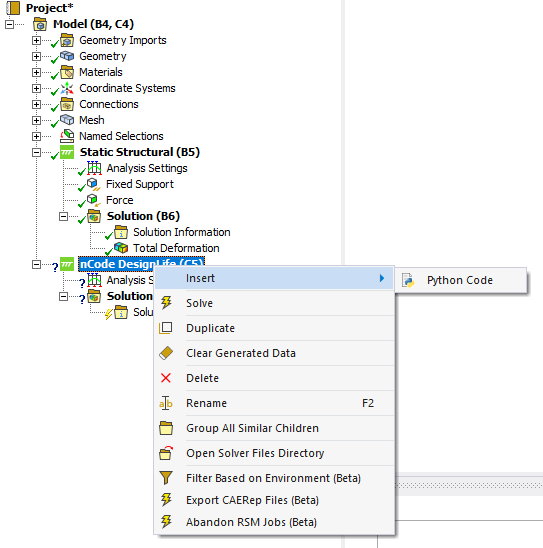

      However I couldn't manage to understand how to apply a filter on the options associated with my custom analysis and I didn't find any reference in the downloadable ACT examples. If you take nCode Design Life for instance (see below), once you right-click the 'nCode DesignLife' object, you find no options under 'Insert' except for 'Python Code', which means the nCode analysis has been filtered somehow. On the other hand, if I right-click my custom analysis, I still get all the default options of a Static Structural analysis under Insert. I would like to be able to filter and remove some of those buttons.

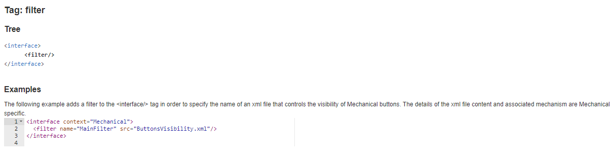

      Searching Ansys online XML Reference guide, I found the following XML tag which I think can be useful to implement the filtering I need since it allows to control the visibility of Mechanical buttons. However, I can't unerstand how the filter should be implemeted.
      I managed to add the same XML tag under the tag in my XML extension file and also created my custom 'ButtonVisibility.xml' control file following an example I found among Ansys default Add-ins. However nothing happens when I open Mechanical and load my extension, which means something must still be missing.

      Yesterday I managed to access 'nCode DesignLife' XML file and I noticed they used the same tag in that extension, so there's clearly a way to do it, just haven't found out how.

      The filter was never fully documented for use by ACT extension writers. I see the LSDYNA extension that is installed with Ansys structural products has an actgui.xml inside which applies a filter. But copying the file to a user's extension and using the filter tag in the XML file doesn’t do any of the filtering as seen in the LSDYNA extension. I believe there needs to be a command to activate the filter once defined. That is why the filter is given a name, so multiple filters can be defined and turn on/off a will in the python script. I have tried to communicate with our scripting experts inside Ansys, but have not heard back yet.
