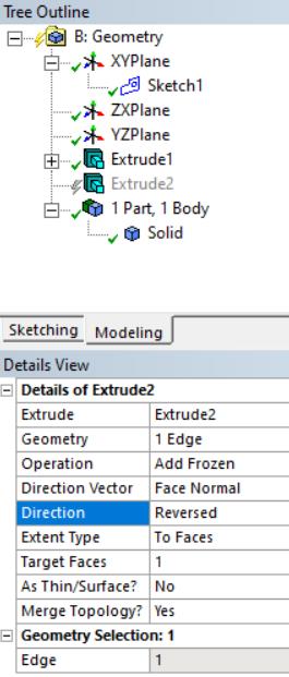

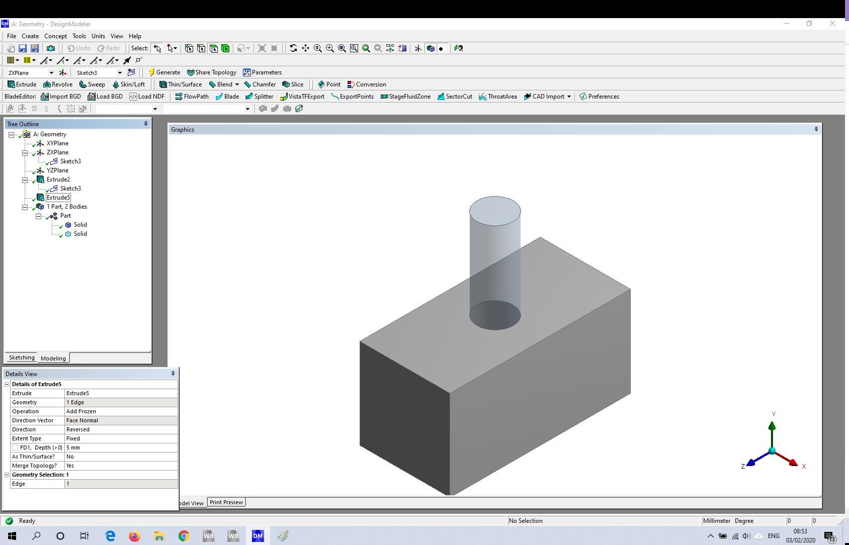

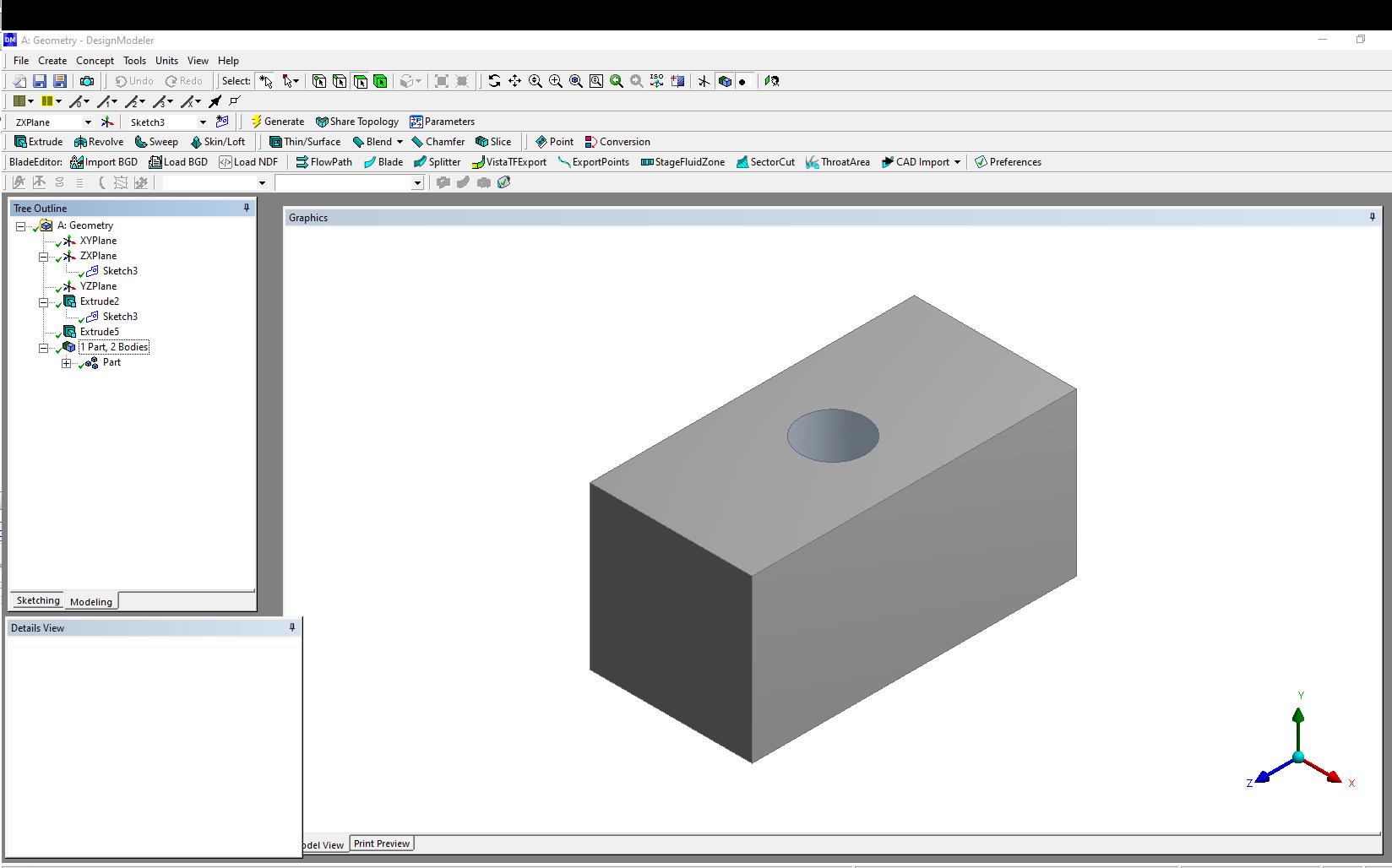

SubscriberCreate > Extrude and pick the edge of the hole. Change the Operation from Add Material to Add Frozen. Pick a face for Direction and then use Reverse. Pick the opposite face for the Extent Type.

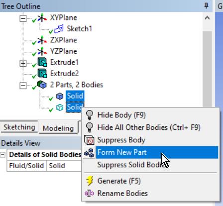

This will create a second solid. To have the mesh connect these two bodies by sharing common nodes, select both bodies and Form New Part.
In Mechanical, each body can be assigned its own material.

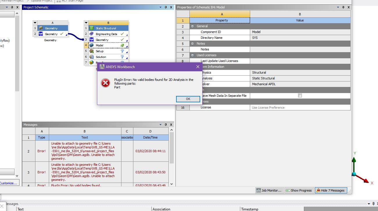

Forum ModeratorYou've got solid bodies (ie 3d geometry) and you're using a 2d solver. It's expecting surfaces on z=0 (I think).Â
February 3, 2020 at 4:26 pm
peteroznewman
SubscriberIf you want a 3D model, then drag and drop a new Static Structural analysis block on the Geometry and in that block, let the Geometry property be 3D instead of 2D. Mechanical doesn't behave when you try to change the type after the attach has occurred.
