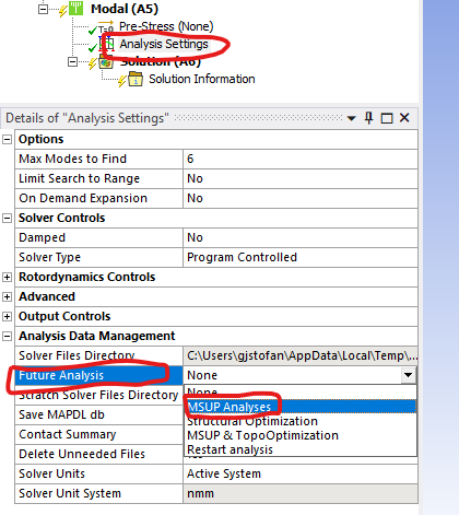

      I am working on pre-stressed MSUP Random Vibration analysis. However, in random vibration stage i get "File file0.rst ( needed for psd calculations) does not exist." error.
      My data for random vibration is PSD G. In addition, I used "BSCOPTION" command for in-core solution for both static and modal analysis
      Any suggestions ?
    • Gary_S
      Hi Mert
       - Suppress the BSCOPTION just to eliminate that as a possible cause.
       - Try setting "Future Analysis" to MSUP:
