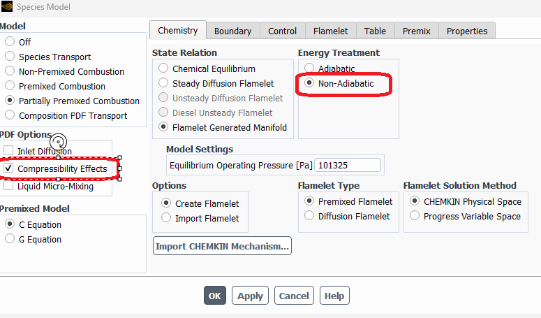

      Your understanding of option 2 is correct. Option 3 is only available for the physical space flamelets. The physical space non-adiabatic flamelet option lets Chemkin flamelet generator transition between a 1d premix freely propagating flame and a premixed burner stabilized flame solution method based on the inlet species composition and enthalpy at the inlets. (This is what the ON switch does.)  Using the non-adiabatic option therefore allows larger enthalpy ranges to be treated correctly.

      A non-adiabatic formulation is needed any time the energy content of the system cannot be fully described by the temperatures used at the fuel and oxidizer boundary conditions of the flamelet solution.  Examples of this are:  non-adiabatic walls, heat sources, or multiple fuel or air inlet temperatures. The Mixture fraction space solution (adiabatic flamelets) will be ok for small enthalpy variations (so long as you activate the switches shown below to capture density variations due to pressure and temperature). For larger enthalpy variations, the Mixture fraction space solution will miss the effect of temperature on reaction rate, which could be quite significant. These larger enthalpy variations will require non-adiabatic flamelets as well as the general treatment for density.
