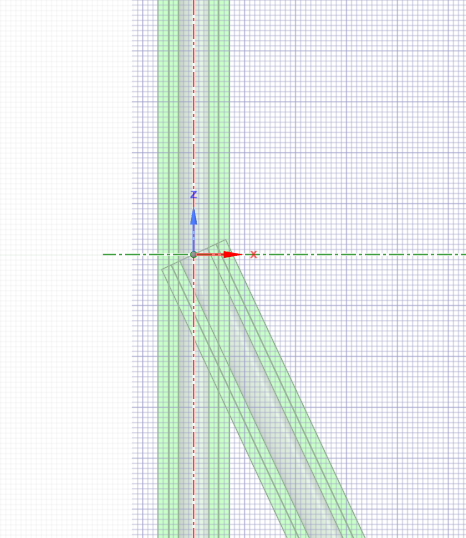

SubscriberIt looks like you are using SpaceClaim. Use the “Combine” tool (yes it is call that even if we do not want to combine). It will create the Boolean of the two bodies. Then we can delete the unwanted regions to get our desired geometry.
