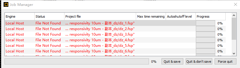

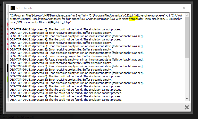

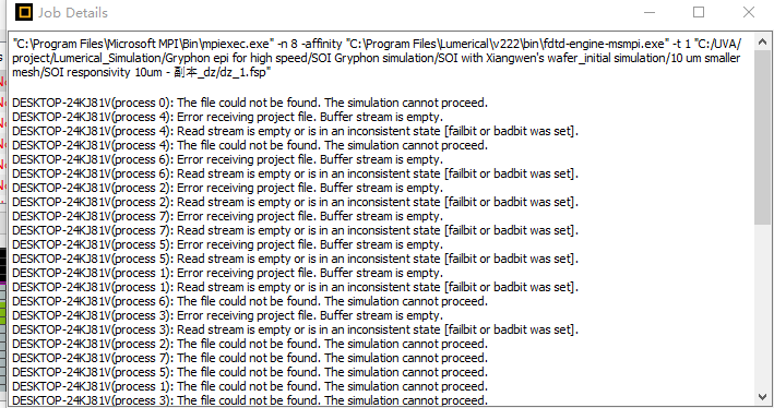

      When I tried to sweep the parameter in the Lumerical, the sweep cannot be processed due to "file not found". Would you mind helping me to solve this problem?
    • Devika Padmakumar Nair
      This error might be due to special characters in the file name, for example the apostrophe or brackts. Can you try running it with a file path that has no special characters in it?
      Let me know if that solved the issue.
