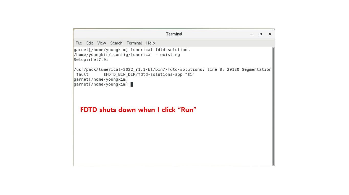

SubscriberWhen I run a bit large simulation in Lumerical FDTD solutions, the FDTD solutions automatically terminates.
This also happens when I try to check the memory.
I have not seen this issue when I run the similar simulation in my past working places (both in Linux and Windows), but started to see this after moving my job.
The error message in the terminal is:
machine-name[Username/Desktop] lumerical fdtd-solutions
/home/Username/.config/Lumerica - existing
Setup:rhel7.9i
/usr/pack/lumerical-2022_r1.1-bt/bin//fdtd-solutions: line 8: 11818 Segmentation fault     $FDTD_BIN_DIR/fdtd-solutions-app "$@"I have tried to solve this within my department, but I could not.
Can I ask whether you have an idea how to solve this? -

To clarify, are you having problems running the simulation file or you cannot open and run the CAD/GUI as shown in the error message?Â
Based on the error message you are unable to open and run the FDTD CAD/GUI. See the KB for options on how to resolve OpenGL/graphics issues on your Linux. Consult with your IT to resolve the graphics issue on your Linux installation. Â
>>> How to resolve system and OpenGL graphics related issues – Ansys OpticsÂ

SubscriberI can open the simulation file and I am also able to edit it. But I can't run the simulation.
Please provide me other solution.

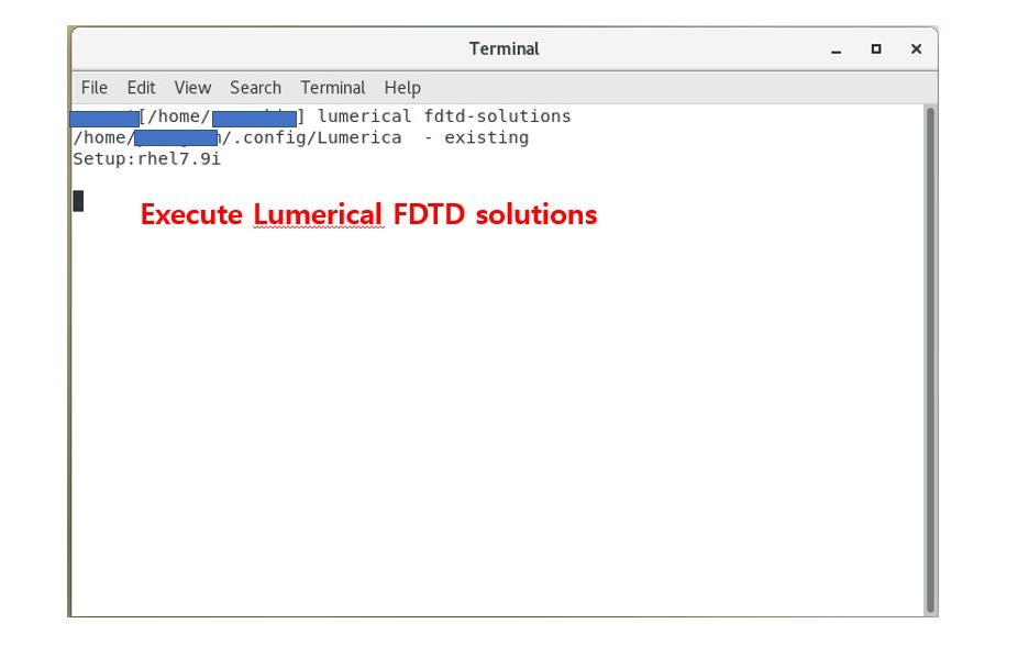

The error message you provided is not for running the simulation file -- this is when you are opening the FDTD CAD/GUI. The command "fdtd-solutions" is what you run for the CAD/GUI. Â
How do you run the simulation file? Are you running from the CAD/GUI or from the command prompt/terminal and what command do you run to run the "simulation.fsp" file?Â
Send a screenshot of your desktop opening and before running your simulation and screenshot of the error message - where you cannot run the "simulation.fsp" file. Â

From your command, it seems that you are running a script that calls the FDTD GUI/CAD. Please check with IT or the person who created the script/executable "lumerical fdtd-solutions" to check what is called by this script/executable.Â
Typically we run the CAD (using the default install path for 2022 R1.1)Â
/opt/lumerical/v221/bin/fdtd-solutionsÂor in your case try opening the FDTD CAD?GUI directly from terminal. Do not use "lumerical fdtd-solutions"Â Â
/usr/pack/lumerical-2022_r1.1-bt/bin/fdtd-solutions ÂFrom your screenshot it shows "Segmentation fault error" -- there is something wrong with your installation. It's could be missing system or graphics libraries needed by the CAD/GUI see this Knowledge Base (KB) for details.
