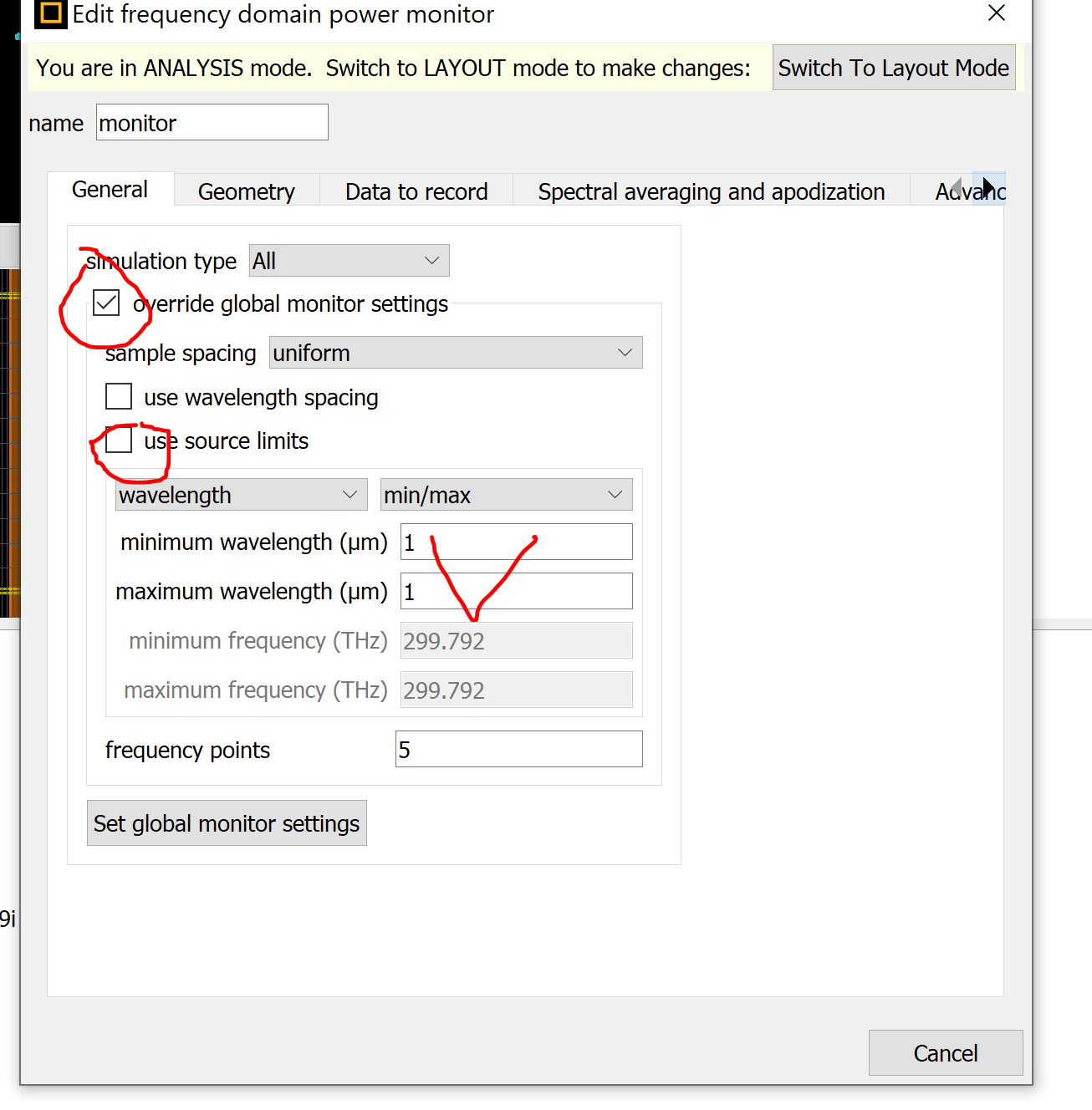

To know if there is any artifacts or the simulation time is long enough, it is better to record broadband result for DFT monitors, which you can simply choose to override the global settings of the monitor and not "use source limit", then specify the wavelength range:
This can be helpful in case the wavelength you choose is at strong resonance. With broadband result, you can check if the result, eg, transmission curve is smooth or not, in particular around the wavelength you are interested in. This bandwidth can be relatively small, and the monitor can record fewer frequency points.
