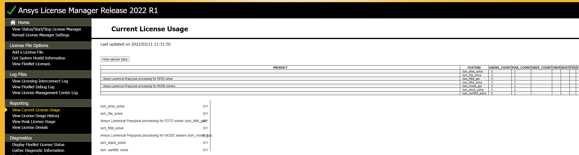

SubscriberWhen trying to run an FDTD simulation I get the following error:
Insufficient lum_fdtd_solve licenses available.
Licensed number of users already reached.
Feature:Â Â Â Â Â Â lum_fdtd_solve
License path: [email protected];
FlexNet Licensing error:-4,132
Unable to checkout the requested HPC license. This operation requires 1 licenses for feature FDTD_Solutions_engine.
Error: there was a failure with the license. Process number: 0 had this error
However, when I look at the license manager, the license is not being used:

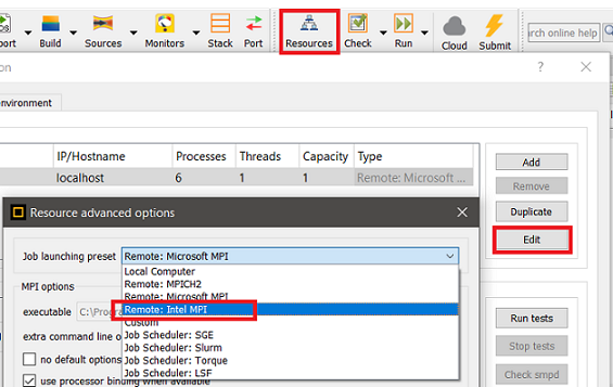

Ansys EmployeeTry to close all Lumerical applications. Reboot your computer and run the simulation with Intel MPI as the Job launching preset.
