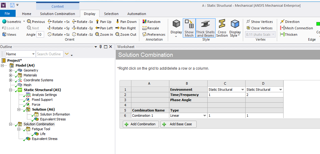

SubscriberAt the Display Time tabs in Definition I understand that I can set the ending time of the cyclic loading, but always the starting time is at 0 sec. How can I define the starting time to be at the 4th sec, since my cyclic loading is implemented at the 4th till the 5th sec.n

Ansys EmployeeThe Fatigue Tool (FT) just uses the FE results from the specified result set. In a static analysis, time does not have any physical meaning. It is just a counter. When you set the Display Time to be equal to 2 seconds, you are just telling the FT to use the FE results that are associated with a solution time of 2 seconds. nIf you want to examine the fatigue damage caused by cycling between result set 4 and result set 5, you need to do a Constant Amplitude, Proportional Loading analysis. You need to set up a Solution Combination that contains result set 4 and result set 5; and then place a FT under that Solution Combination. The FT will use the alternating stress between result set 4 and result 5 to determine the fatigue damage.n -

SubscriberI understood what you mean and I appreciate your interest!nI am afraid that I do not know how to extract the 2 result sets that I am interested in, from the multi-step solution and how to prepare the simulation that will consider cycling loading between these two results sets.nn -
