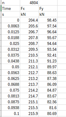

I have my model all setup, meshed, BC's, Loads, etc. I have added the fatigue tool box as well. Now, i am curious to know if ansys can take what i call a "loads file" and use that for fatigue? A loads file is basically a 3 column excel file tah has Time, Fx, Fy. Where time is in seconds and they are time stamps, Fx is force in X etc etc
Time  Fx  Fy
0Â Â Â Â Â 400Â Â 200
0.25Â Â Â 450Â Â Â 260Â
this is the basic format but imagine about 1200 cells. When graphed, it is cyclic.

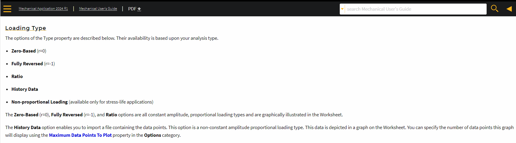

I was looking throug the types of loadin in the tool box and saw a "hisotry data" and was wondering if this is the same thing? if it is, whats the format need to look like?Â

Subscriberok, so how should the format be?
My loads file has 3 columns, time, Fx, and Fy. What does Ansys want in the single column? Loading in the Fx only? I am going to probably assume yes since it looks like the Fy is not cyclic and time is for sure not cyclic... That would suck haha Non linear time, thats a good discussion haha.

Ansys EmployeeThe Mechanical Fatigue Tool (FT) will accept a single column of ASCII data as History Data. Time is irrelevant because it does not affect the fatigue calculations, so the time column can be removed. The FT applies the History Data as multipliers on the total stress. It does not apply the multipliers to the loads. You cannot specify a multiplier for individual loads (FX, FY, etc.).

Ansys EmployeeAnsys offers two fatigue software tools: the Mechanical Fatigue Tool (FT) and Ansys nCode DesignLife. The FT is an entry level product with limited capabilities that is provided free with a Mechanical license. Ansys nCode DesignLife is an advanced tool that requires a separate license. You cannot do a precise fatigue simulation for your loading scenario using the FT.
It looks like the orientation of the force resultant vector for each loading is relatively consistent. You could find an average resultant orientation and assume that it applies for all time points. You could then convert the FX and FY loadings at each time point into a resultant force (SRSS) and use the History Data approach in the FT to predict the fatigue damage. The predicted fatigue damage would not be precise, but it should be in the ball park.
You could also use the FT to bound the fatigue results. For example, you could determine the worst-case loading scenario and then assume that the stress range caused by that loading occurs at all time points (probably assuming zero-based loading). The predicted fatigue damage using that assumption would be more severe than the damage produced by the actual loading produces.
Note:Â Regardless of the software tool or loading approach, you need either a SN or EN curve to do a fatigue evaluation.
