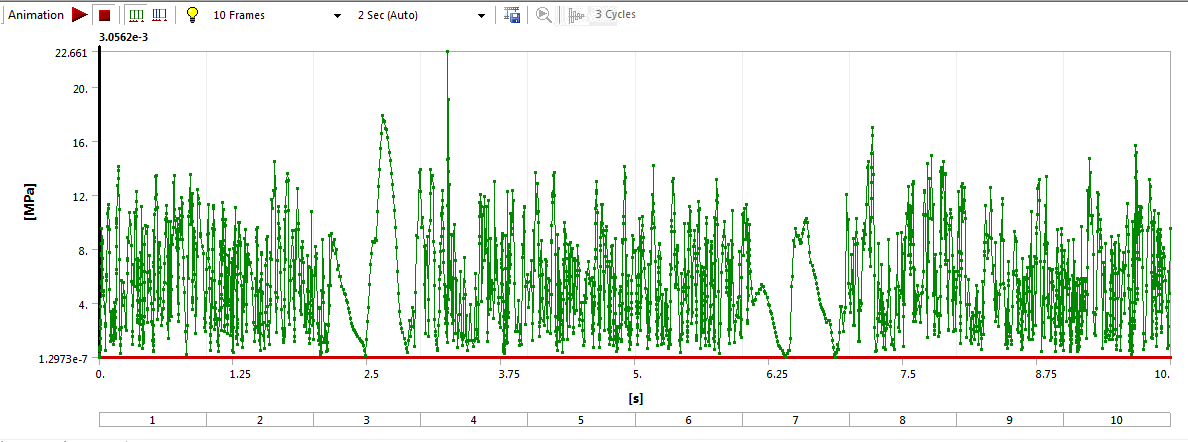

I have stress plot over 10 seconds of time and now I want to see the fatigue life. I need to enter a time under "display time" so fatigue life will be calculated based on the stresses at that particular time. However, I want it to take the RMS value of my 10 seconds data.Â
Another option is to change the loading type to "History Data" for which it requires .dat file. How can I create the .dat file of my stress data? Or any way to insert RMS value?Â

SubscriberMy stress results are from simulation. I then attached the fatigue tool to see the life of the component.
I am using Transient Structural and added equivalent stresses under solution. So that I have Stress vs Time graph. Now I want to check the fatigue life of my component.

SubscriberWhat was in scope for this stress plot? A body, a face, an edge or a vertex?
You can imagine that during a transient simulation, the maximum value of stress can jump around to different places on the body. That is not an appropriate dataset to accumulate fatigue damage. The same is true of a face and an edge. It is only a vertex (or node) that is a valid scope to plot stress to do fatigue damage accumulation.
Also, was this Equivalent von Mises Stress? That is always positive so you can miss the true amplitude of the stress cycle. Something called signed von Mises is better.
Take your Stress-Time history data at a vertex into software that does the rainflow counting into bins, computes the fatigue damage on each bin and does the summation of total damage using Miner's rule. I have used a matlab script called vibrationdata to do this calculation.

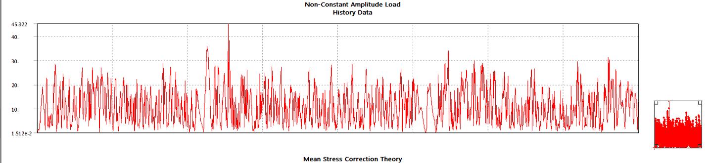

Above stress vs. time graph cannot be inserted as .dat file in fatigue tool loading?
May 15, 2019 at 8:50 am
Naveed
SubscriberOK I have found out that I can use the my Y-axis values of stress vs time graph and upload the .dat file for fatigue analysis. This procedure will take into account the rainflow counting as suggested by you the better way than using RMS value.Â

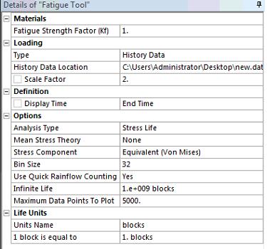

SubscriberNow I am just confused with the "Display Time" option. I know that if I select 5 it will pick the stress value at 5s and calculate fatigue on that stress value. But if I am using History Data why is it asking for the time? Isn't it the same thing then? I want this whole block to be used as 1 cycle, not a single value at any given time.
Please advise.Â

SubscriberI haven't used the Fatigue Tool on a Transient model. I don't know what the Display Time does.

What the history data does here (this is done in static analysis normally) is to multiply a unit load case (and hence just scales/multiplies the stress results from the unit load case, that is why one can input a scale factor) with the history data (this says how the unit load varies with time) in a static structural and then does rainflow counting and sums the damage, and this is not what you are asking for (now I do not have any experience on this matter except of writing some simple fatigue code for Strand7 which is the software I work with).

I do not know whether to feel proud or stupid as I want to do something that is not even in the scope of ANSYS. Haha, Anyway, what I can try is upload my History Data and pick a "Display Time" where my stress is 1MPa and hit solve. I think that would work. I want my 10 seconds of stresses to be taken as 1 cycle, and it would do that. (Y)

SubscriberI am currently doing transient simulations for seismic analysis, and have a strong interest in fatigue, so it was worthwhile to put the question to my ANSYS support team. Here is the answer I received...
Unfortunately, you cannot use the Fatigue Tool to perform a fatigue analysis on an entire transient structural analysis solution. This is beyond the capability of the Fatigue Tool as it is meant to have only basic functionality. You can only look and evaluate a stress result at a specific point in time. This of course defeats the purpose of the transient analysis.
This type of fatigue analysis would require use of ANSYS nCode DesignLife. It can handle this analysis very easily.

SubscriberSorry for late question. Coming back to the fatigue part of my project, with reference to the reply Peter got from ANSYS, my question is what is the purpose of rainflow counting and history data if the stresses are evaluated at only a specific point in time? I mean it looks same as if fully reversed cycle is used which has 1 magnitude going up and down.
Even after reading theory about rainflow counting method I could not understand how ANSYS solves it. If there is any document I can refer to, plz suggest.
May 28, 2019 at 4:32 pm
Gaddsch
SubscriberRainflow is done to your imported history data i think. As you mention, it is not possible for a single loadstep.
