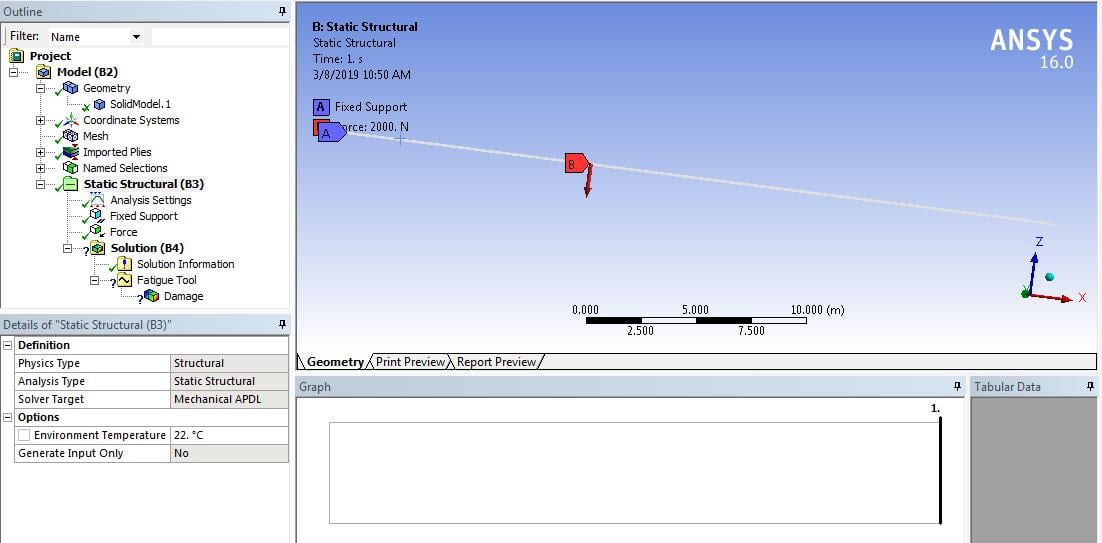

      Problem in fatigue tool
      sir, we have only workbench 16.0, while solving fatigue tool we encountered the problem like this image ,  and the error message is "You have chosen an invalid result for the current analysis'. what's the problem?
    • Sandeep Medikonda
      Karthikeyan,
      The Mechanical Fatigue Tool only does SN and EN fatigue, which is typically applied to ductile materials. It does not have any "special" tools for composite materials.
      I have seen SN applied to some composites.  It can be used if a valid S-N curve can be developed.  That approach does not look at fatigue at the micro level.  It just assumes that the composite fatigue behavior can be represented by a S-N curve at the macro level.
      In your case, click on the Show Errors button in the Mechanical GUI and it will tell the reason why.
      Sandeep
