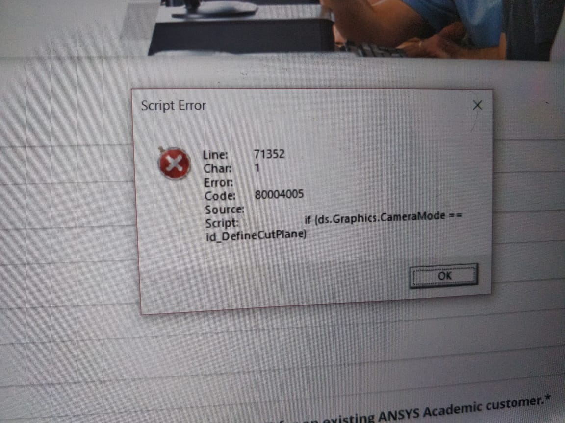

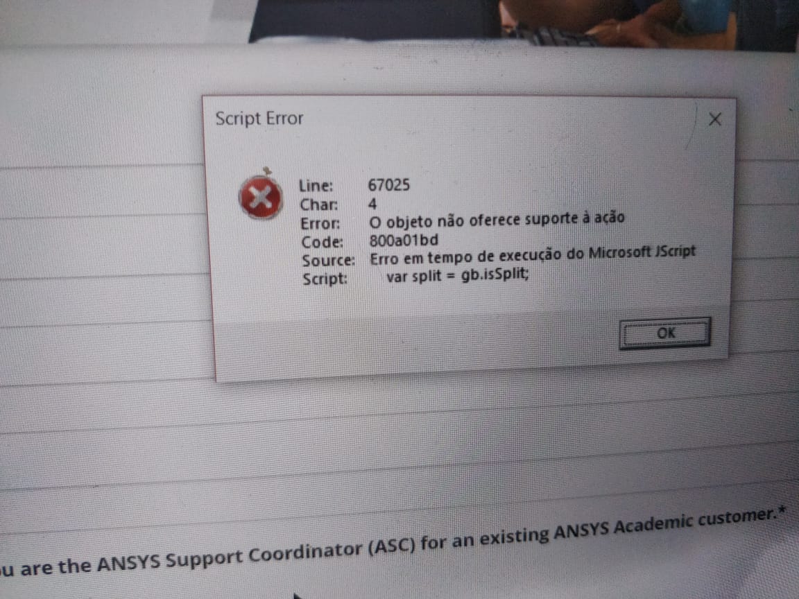

      Hello, i am using ansys student for a college work about airfoils
      I created the Control Volume for the airfoil, but when i try to open the Mesh creation , i get a lot of errors and ansys crashes
      Anybody Knows how i can solve this problem?
    • Keyur Kanade
      Can you please translate errors in English and let us know.
      Can you please exit. and please go to C:Users[user_name]AppDataLocalAnsys and rename v190 to old_v190
