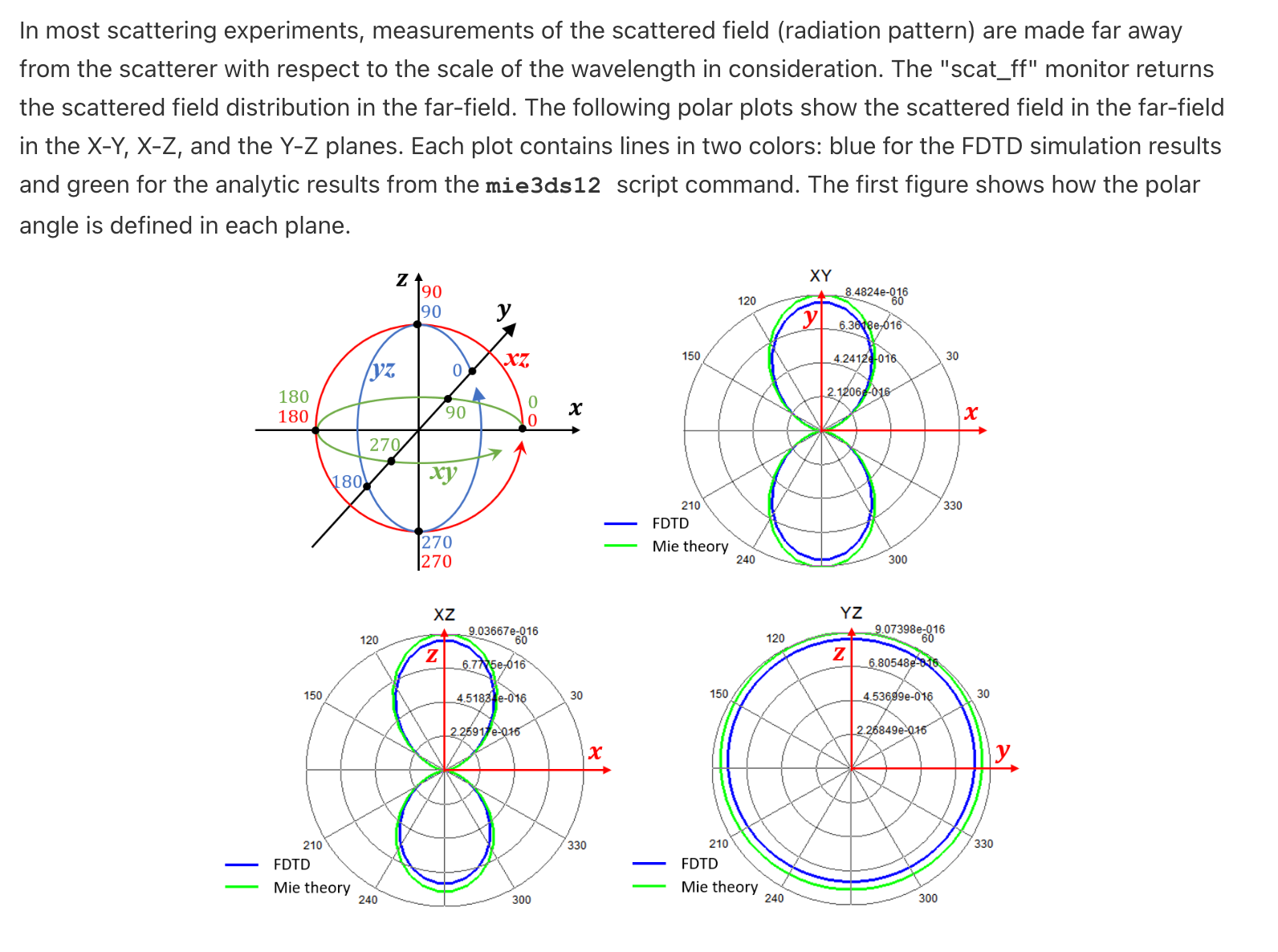

      Here with the "Scat_ff" 3D monitor, we can extract information about the radiation in XY and XZ planes. But it is possible when there are no material interfaces are there.
      For my case, I want to see the 2D emission profile (XZ, YZ) from a dipole (along x direction) situated inside a metamaterial. In my case there are material interfaces. Please suggest how to calculate it.
      Thank you.
