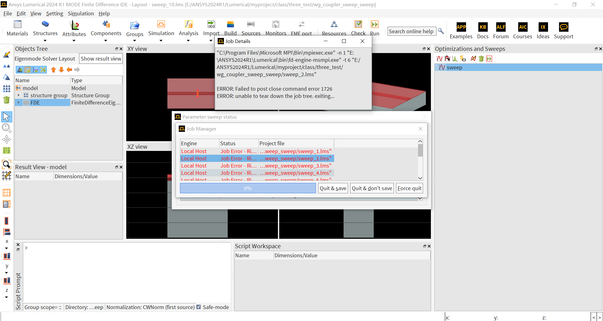

    • 202301201073
      亲爱的工程师,您好,在MODE扫描运行仿真时,出现了如下报错,导致的原因和解决办法是什么呢,万分感谢
      ERROR: Failed to post close command error 1726
      ERROR: unable to tear down the job tree. exiting...
    • Guilin Sun
      Most likely your sweep files are corrupted. Please restart your computer, check the files with sweep parameters and see if there is any abnormlity.
      Please write a new post for new questions as the old posts are not monitored closely.
