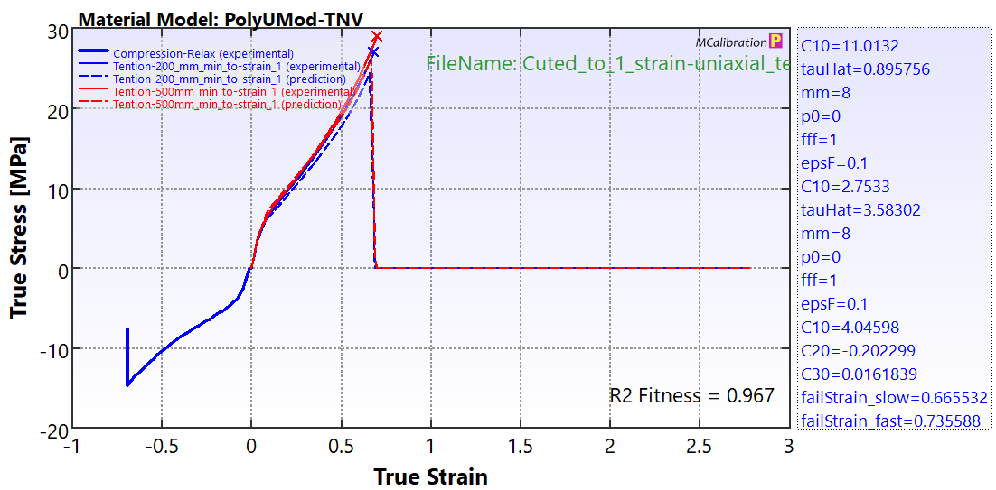

SubscriberI seem to have solved a simple test problem—uniaxial tension of a flat specimen with failure—using the aforementioned method.
Quick Calibration of a PolyUMod Failure Model to Experimental Data

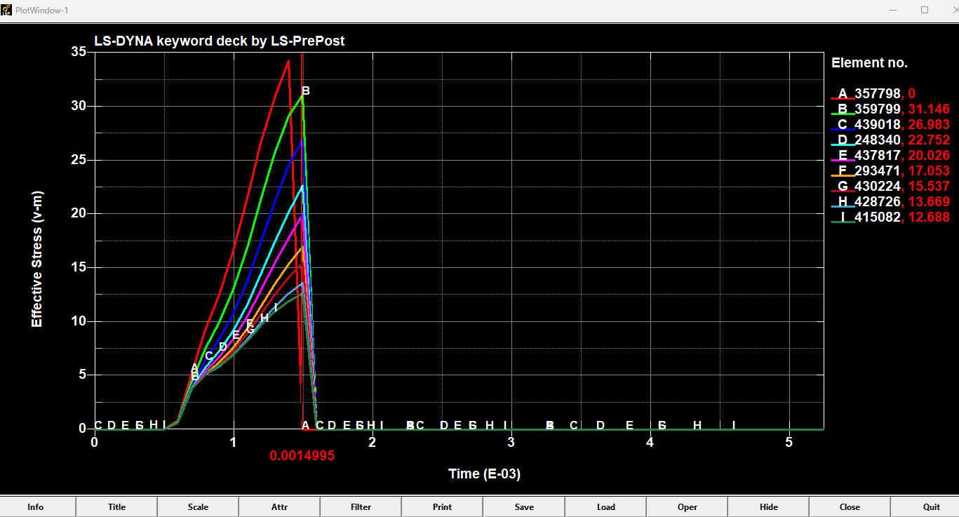

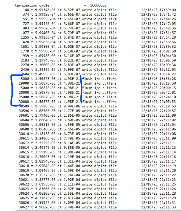

https://www.youtube.com/watch?v=Qd1Pvqh20vE*** I’m using LS-Dyna and Polyumod 2022.I’m seeing some issues:1. When using the TNV model, LS-Dyna doesn’t record, or records incorrectly, deformations and displacements for the entire model.That is, zero values are returned if I try to plot graphs and then write the values to a file.2. Visualization issues:- Visualization of the deformed model is possible before resolution, but if I try to display deformations or displacements for a single point, all values will be zero.- After failure begins, visualization of the ENTIRE model is impossible.Despite the lack of deformation and displacement results in the database, the calculation itself—up until failure—results in a realistic model (like a full-scale experiment and the results of calculating and calibrating the constants).*** I have some assumptions/hypotheses:When solving problems, LS-Dyna incorrectly records the values of some variables for this model in the database or records them in a way that the postprocessor “doesn’t see.”The stress graphs constructed from LS-Dyna calculations are very similar to reality.I solved the same model using an abacus without any problems —the calculation results are very similar. -

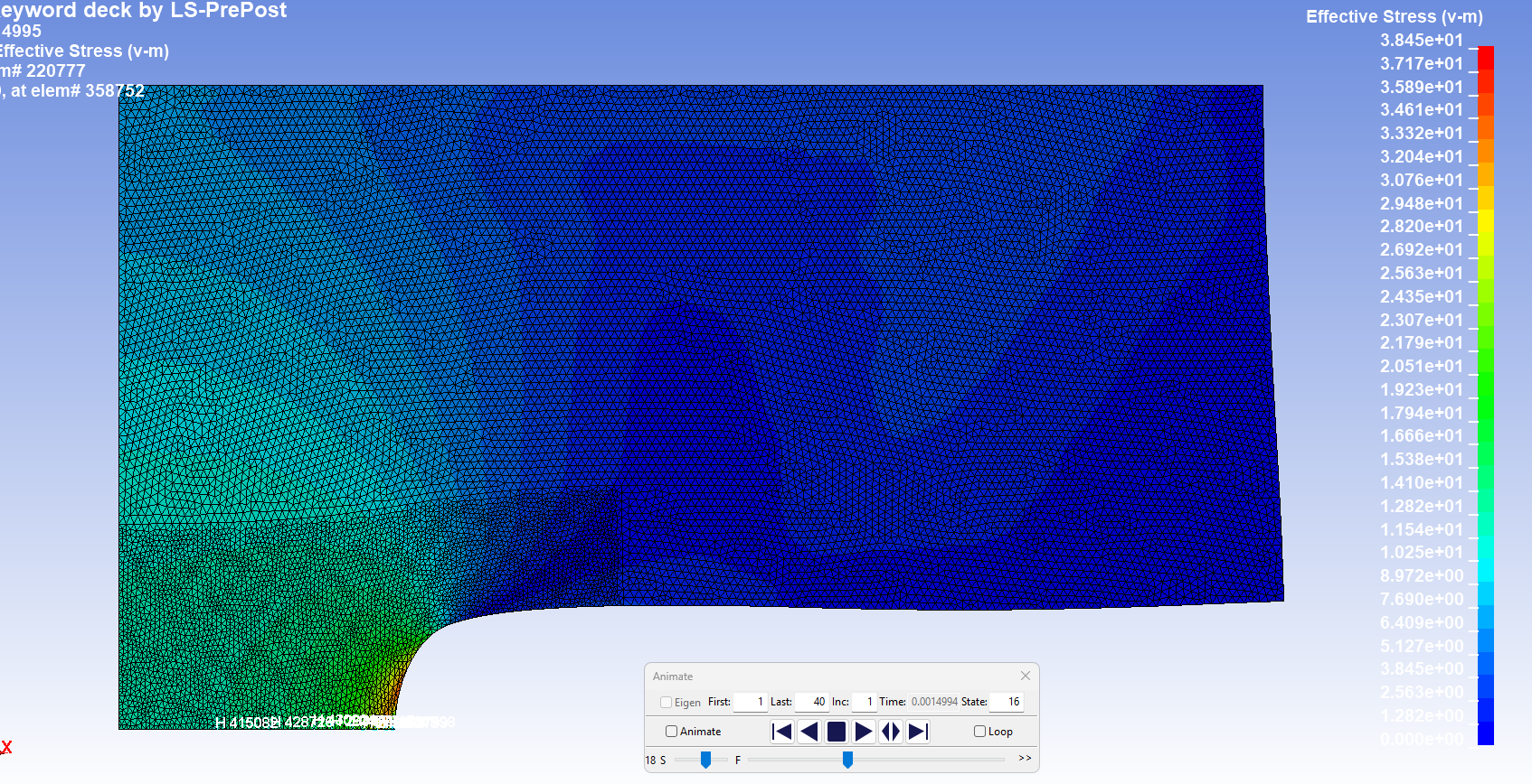

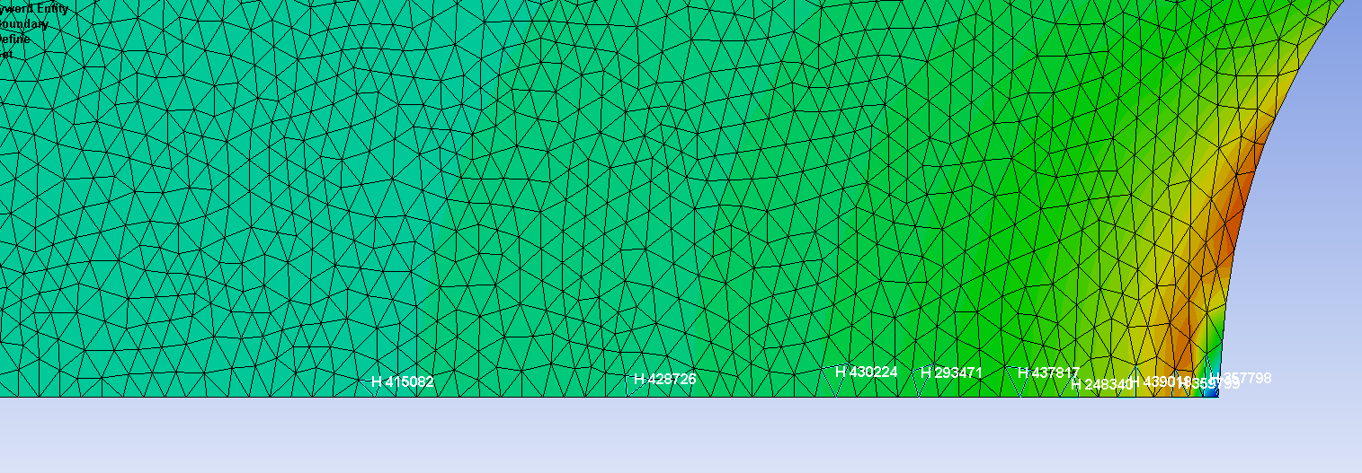

valerym.m5

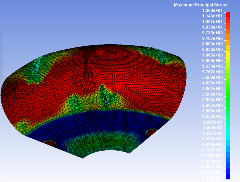

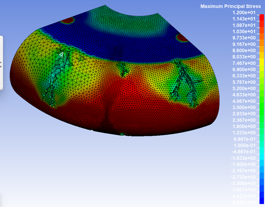

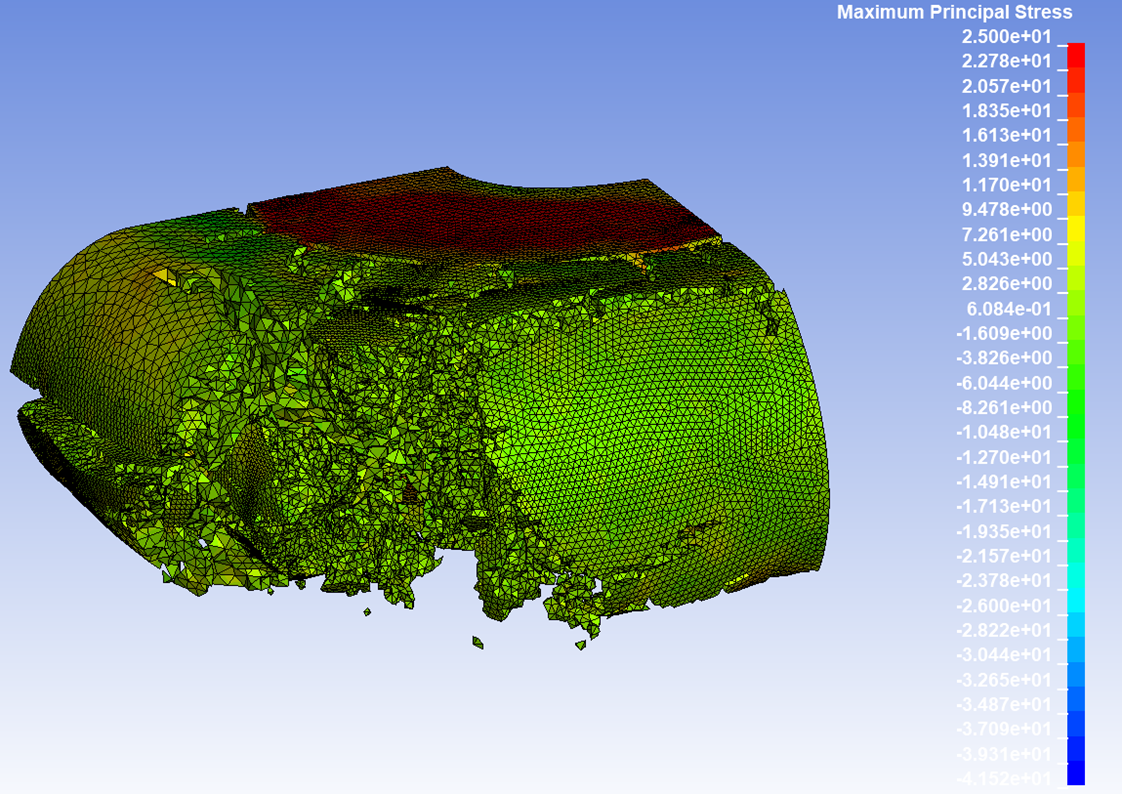

SubscriberI've run several test simulations using MAT_ADD_EROSION (the SIGP1 Maximum Principal Stress at Failure failure criterion).
The crack formation locations and shape are very similar to the results of the full-scale experiments.
However, the subsequent crack propagation and failure of the part are completely different from the full-scale experiment.
I would be grateful for your advice and comments.
