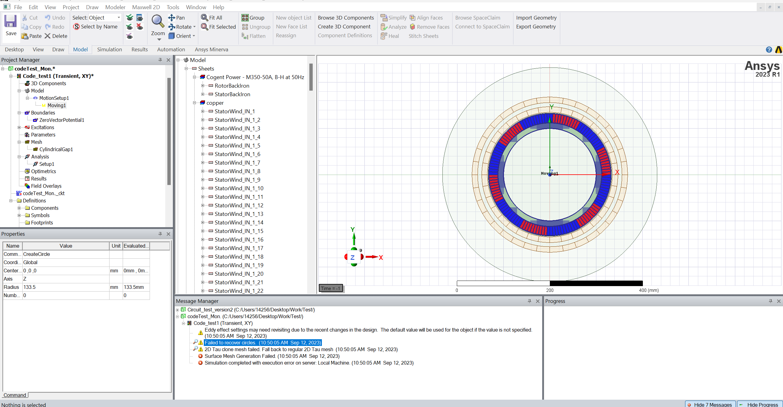

TAGGED: -Ansys-Maxwell-electronics, 2d-mesh, meshing

GLUO

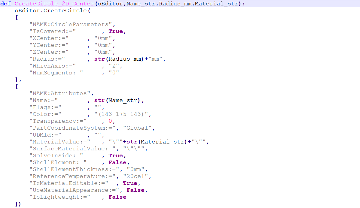

Ansys EmployeeHi Zhengting,
Do the circles like rotor, inner band, motion band you created via scripting have segments=0 in their properties?
GL
September 14, 2023 at 11:03 am
September 15, 2023 at 7:18 pm
GLUO
Could you submit a case ticket through Ansys Support Space - Innovation Space ? We can have someone look at your model with issue directly.
GL
September 19, 2023 at 6:45 am
Zhengting.Wu
SubscriberHi,
thank you for your suggestion, I try to do that and get this information: "Your account shows you are not eligible to receive technical customer support from Ansys and, therefore, will be unable to open cases. Please contact your Ansys Account Manager for any questions." My account is for student, I think this function is not for me :(
September 19, 2023 at 3:48 pm
GLUO
Please make the rotor and magnets non-mondel to debug which geometry caused the error, and please also add a inner band between the motion band and the moving objects if you have not done so.
