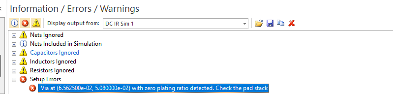

DCIR Drop Test Issue
We imported an ODB++ file of another PCB and attempted to perform a DCIR drop test.
The tool reports a "zero via plating error", pointing to a specific location in the PCB design. However, we have thoroughly checked, and there is no via at that location.
We have validated the via placement multiple times, but the error persists.

DCIR Drop Test Issue:
Sometimes the Siwave does not exactly show you the exact location of the via placement. Is there any vias around that has zero-plating defined within it's padstack properties? Siwave not showing the exact location of the via might be a defect of the tool, but it is hard to confirm without having the project.
Here are my suggestions:
- First, try to identify if that one particular via is important to the simulation. Cross reference is with you PCB board in another ECAD viewer. Since the simulation finishes, it may not be a big deal if it is not relevant to the area you are checking for DCIR.

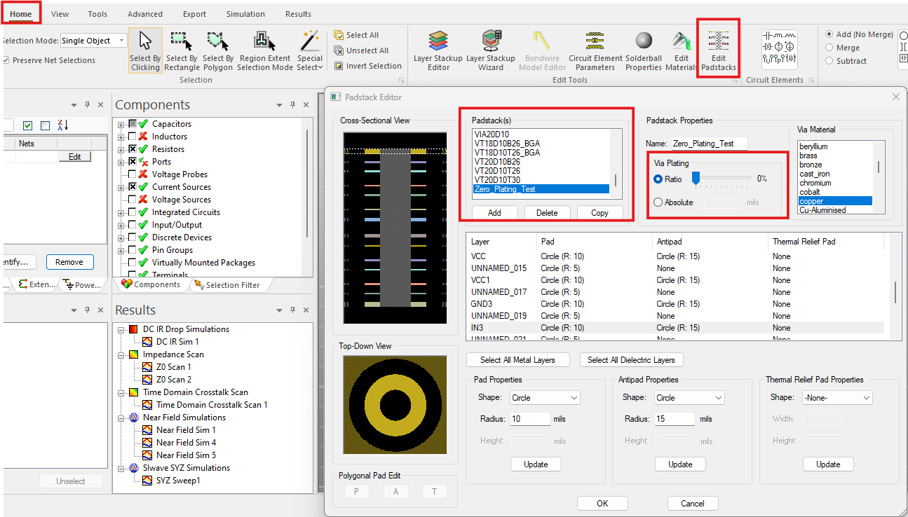

- Secondly, Verify that all your padstack definitions are correctly defined for you vias. You can check padstacks by doing to the "Home" tab and then select the "Edit Padstacks" button. This will open up the padstacks and you will need to go through each padstack to find out which one has zero-plating define and change it. See image below
