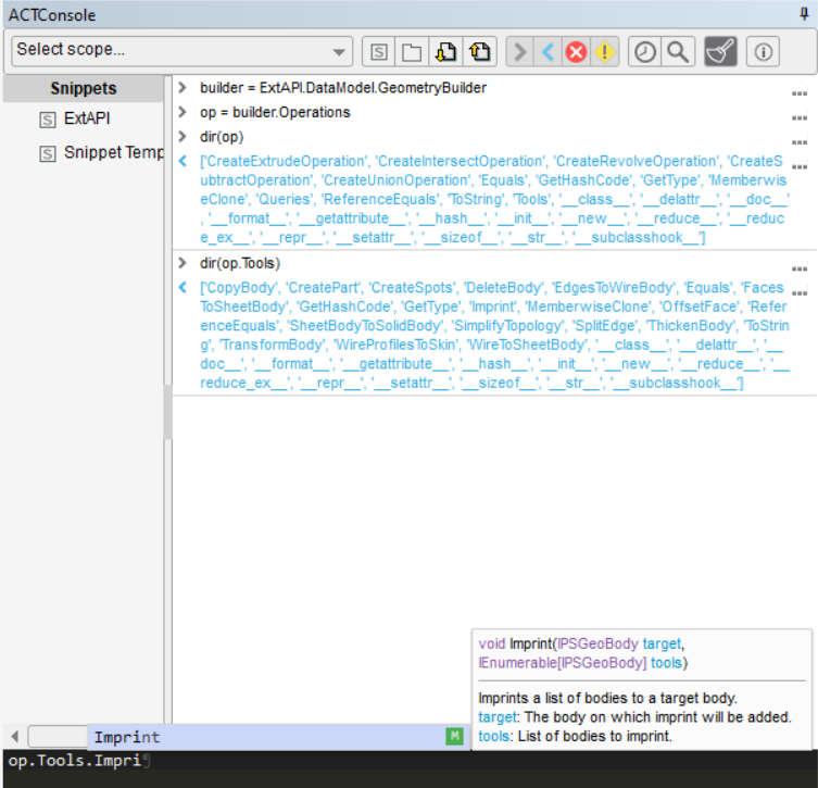

      Within an ACT extension inside DM, it may be possible to split a face using the imprint under ExtAPI.DataModel.GeometryBuilder.Operations.Tools:
      Or maybe the face split could be done as a slice.
      The only way to do a slice in batch, as part of a user-defined feature in an ACT extension, is to do it as part of an extrude or sweep operation, since you can choose the option to slice while extruding or sweeping:
      feature.MaterialType = MaterialTypeEnum.Slice
      Example called by :

      Or it may be possible to make some python commands to insert the native "Face Split" feature you would see in the Outline and set selections and any other necessary options, but I don't see an examples of this done yet.
