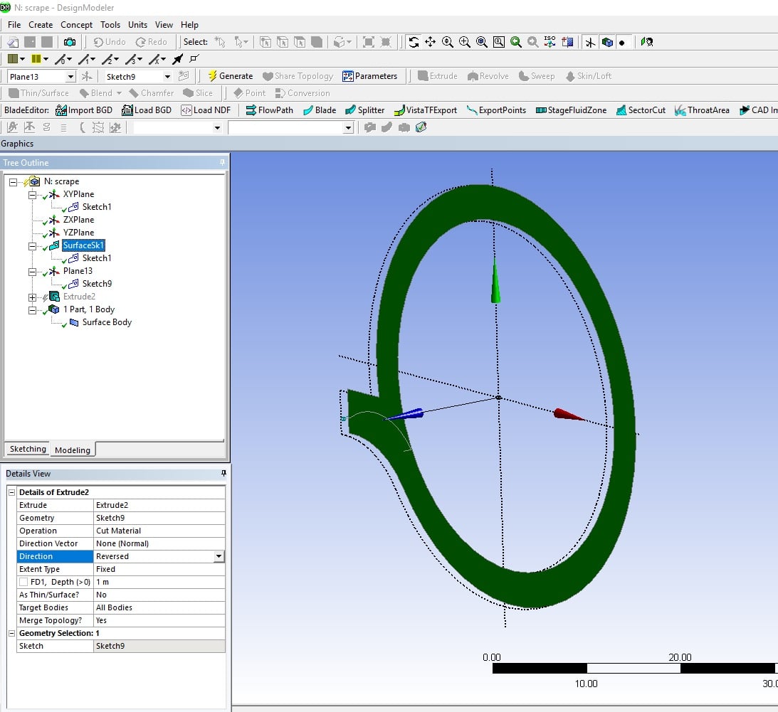

Keyur Kanade
Ansys Employeeyou can create a line from from that sketch of arc.Â
then use tools - project to project this line on surface. this will split the surface.Â
March 8, 2019 at 10:25 am
usama
Subscriberi did this what you say but can not working and also apply peter and kkanade method may be i am missing something please guide or i can attach my geometry or tell me any video regarding this. see the attached figure. please tell me where the extruded surface go after slicing? because i need a 2D surface. please check the figure.Â

Rob
Forum ModeratorYou may need to move Plane13 off the plane the geometry is on: I've found imprints/extrude for cuts not to work well when the planes are coincident. In the Plane13 definition there will be an option to offset in the (probably) z-direction. The offset only needs to be a few mm.Â
March 11, 2019 at 11:26 am
usama
SubscriberDear rwool hou
I moved the plane 13 offset in z direction then use extrude cut command in the reversed direction. I moved the plane from base plane about 1mm then use extrude cut command in reversed direction but not working. Please explain further. -

Rob
Forum ModeratorThe extrude+cut should slice the geometry: assuming it does pass through the surface?Â

usama
SubscriberDear Peter In reverse extruded length 1.01mm but IÂ moved offset z plane 1mm. my question is length should be the same or reverse extruded length should be greater than the moved offset plane length?Â

peteroznewman
SubscriberThe idea when using a line or a surface to cut a body (surface or solid) is that the cutting geometry should start outside the body to be cut and extend past the body to be cut. The line or surface should have a greater lateral extent than the body being cut, if possible.
The idea is to avoid geometry that is just touching because small tolerances in the geometry can create gaps that hurt the downstream use of the geometry.
If you understand these ideas, you will know what to do in any situation. Sometimes the touching is unavoidable because you want a tangent condition. In that case, you have to hope for the best. Most of the time it works.
