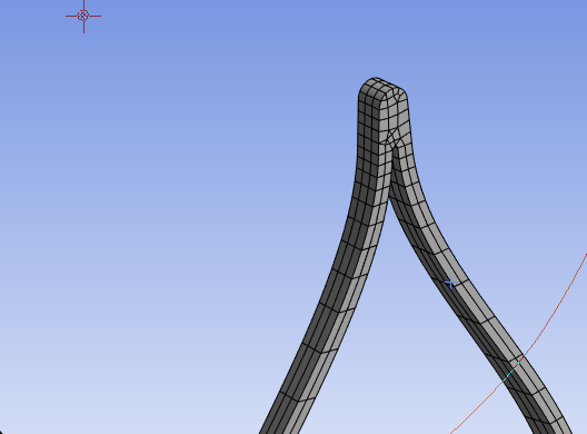

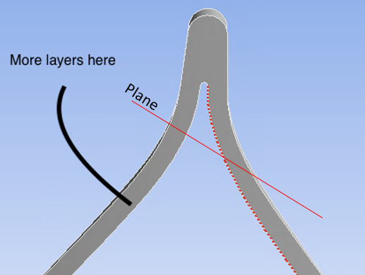

      I have a problem with face meshing the structure like in the photo 1. I want to have more layers and i've tried to choose an element size for the surface but instead it meshed the thickness of the structure (photo 2). I've tried face meshing but it didn't work also. Can someone have an ideal how to obtain more layers on the surface?

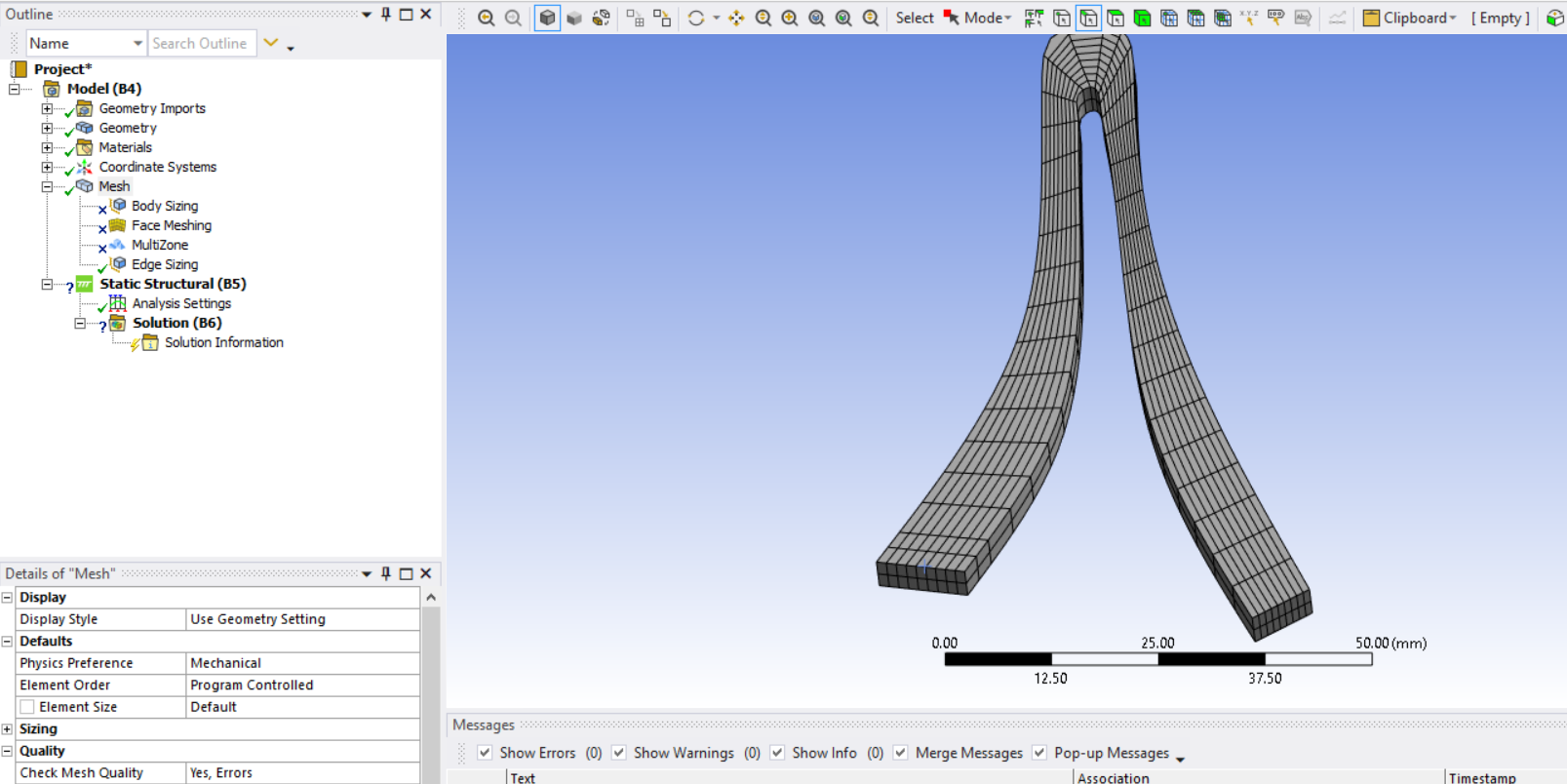

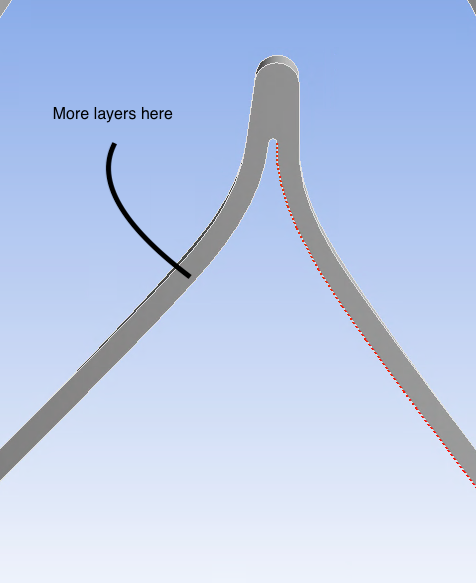

      I'm using Multizone Haxahedral to create the mesh. I've tried sizing like you mentionned but it didn't work.It always meshed the thickness if i do that. My structure's thickness is 3 times greater than the width ( in your photo, the width is bigger than the thickness). And the head of my structure is more complex. Do you have any ideal?

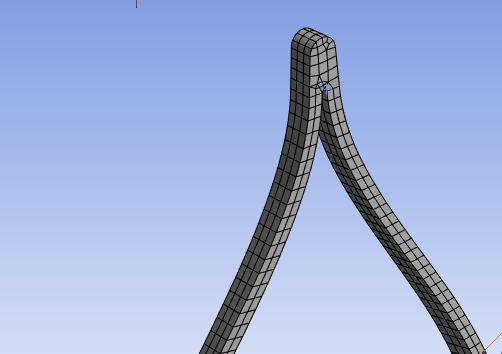

      Here is some photos of the mesh which i used multizone Hexahedral and Edge Sizing. The first photo is with only multizone and the second is Hexahedral and Edge Sizing. It only concentrate meshing the thickness not the width which i need to mesh. Thank you
      Open the geometry in SpaceClaim. Add a Plane and use the Move Tool to position the plane as shown below.
      Use Split Body to slice the solid into 3 parts. Use the Combine tool to reattach the top part to the the right leg.
      On the left leg, look to see if there is more than one face on each side of the leg. On the Repair tab, use Face Merge to combine faces. You want exactly 6 faces on that leg.  Click on the Split Edges button to eliminate extra vertices in the geometry. On the Prepare tab, click the Share button.
      Open this geometry in Mechanical. Right click on Mesh and Show Sweepable bodies. The left leg should highlight in green.  Now you can insert a Mesh Method and select Sweep.  If you pick the left side face as the Source face, you can type in the Sweep Number of Divisions to be as many elements across the front face as you want.

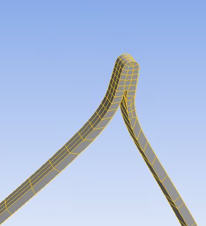

      I've tried like you said about cutting the stent into pieces and finally it worked! Thank you for your advices. But i only managed to mesh one ring of the stent. But my stent has a lot of ring. To be efficient, is there anyway to copy the mesh from the first ring to other rings? I've tried to use Mesh Copy but Ansys doesn't like copying from multiple surfaces ( divided surface) to one surface!

      It's better to build the geometry in SpaceClaim for the entire stent. If you have one ring built, use the linear Pattern to create all the other rings. The first end ring would be reflected about the center plane to get the other end ring (which may need to be clocked).
      I use other meshing software (Femap) to copy/translate meshes and merge nodes, so I haven't tried to figure out how to do that in Ansys.
