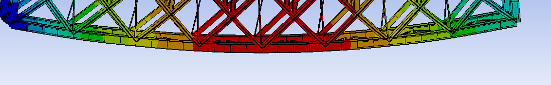

      Hi all My model is constructed with a line body. Please see attached bottom chord of the truss bridge model.
      I want to extract nodal displacement result along the path from left to right (bottom chord). Could someone please help me. I am using Ansys Mechanical 2021.
      Thank you.

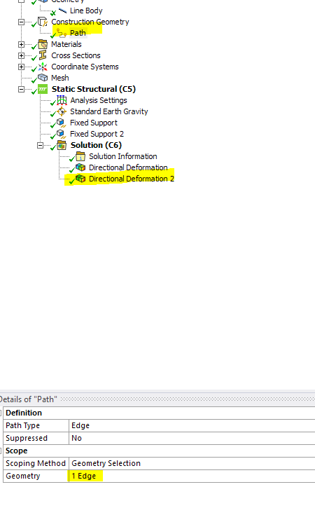

      Define a path as shown and scope it to the edges:

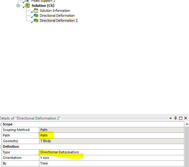

      Then scope the path in the results:
      Erik

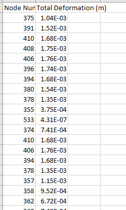

      Hi Erik Thank you for the information. I was able to extract the results along the length. Now I want to extract the nodal results from left to right (393-390-392........). The node umbers are not in order from left to right in the result I extracted. Please see attached figures.
      Sand

      See if this helps (exports nodal coordinates with results).
      Then in excel do a custom sort based on the column with the coordinate of interest and sort all the results.
