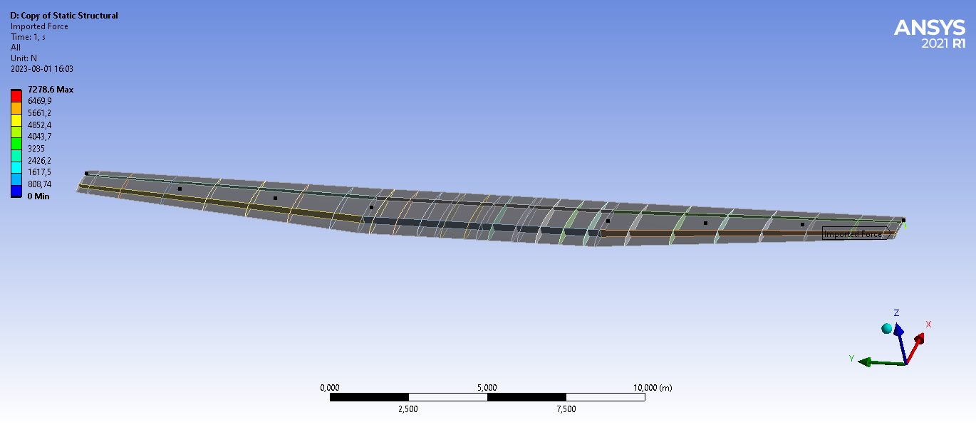

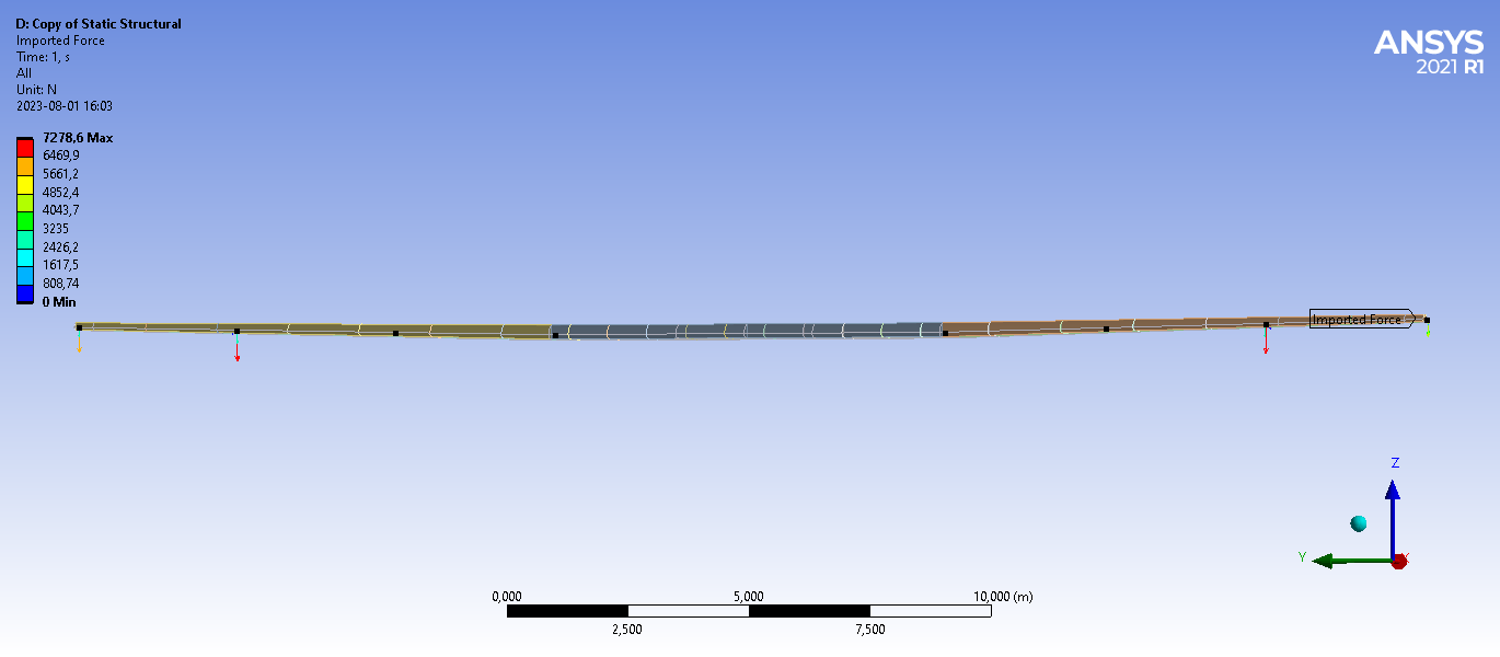

I am trying to import point loads on a wing that represent the engine nacelles. However, I don't understand how the mapping works. I had tried adjusting coordinates many times, and it always results in a few points not getting mapped, even though all points seem to fir the criteria of being on the surface or in the model.

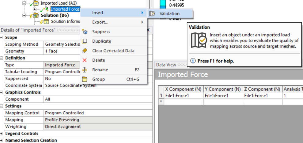

Please see the following images that show the problem. I can't use the profile preserving mode, since that results in a really high unphysical load.
How does the force mapping work in ANSYS static structural, and how do I improve the mapping so that all forces are mapped correctly?

I am importing the load as external data from a CSV file, with coordinates, and you can see the results in the pictures I showed. This is not mapping correctly.

Would you please provide some more details on the process which you're following to import the force data, is the data an experimental one or from an FE model?
If seen from the image, there are certain forces that have been imported, thus if the input data is in the correct format, all the points can get imported at the requested locations.
You can also check the efficiency of the imported data for the FE model via the transcripts to ensure a maximum of your input data is reflected in the given model.Hope this helps!

SubscriberHi Ashish and Sahil,
Thank you for the help. I was able to access the help files and correct the mapping by adjusting the imported force coordinates.
