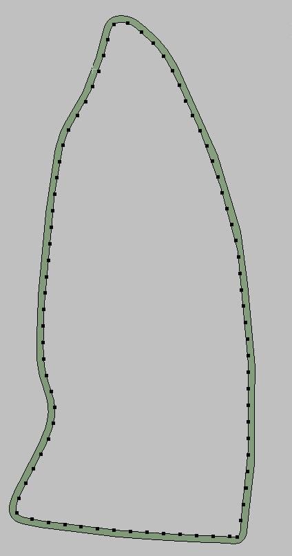

      Hey all,
      I have an issue with using the Imported Displacement feature in Mechanical. Briefly, I'm attempting to model the motion of a wall by using the External Data module in Workbench, and then import this into Mechanical. I will map x-y data points (not mesh nodes) onto my Mechanical mesh, and use the Imported Displacement option to move. The Mechanical model is a 3D wall, approximately 1 mm in thickness and extruded out by 1 mm.
      I can import my data points very easily, as shown in the first figure. I have appropriately calculated the displacement and have set this up in Mechanical. My issue lies in the mapping function. Regardless of what settings I use, when I run my simulation the results show a highly distorted mesh (second figure). Any recommendations would be much appreciated!
      I understand this isn't a lot to go on, so I will be more than happy to provide further details about my setup.2D points that are mapped on a 3D body. This is a nicer attempt. However notice the extreme distortion on the lower right corner.

      I think I found a setup for my Mechanical issue that might work out. By using a coarser mesh, and Distance Based Average for the Mapping, along with setting the number of points to 7, I was able to get smooth motion. I don't necessarily have a reason why this works yet, I found this through trial-and-error.
      Thanks!
