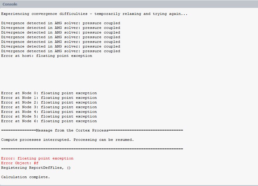

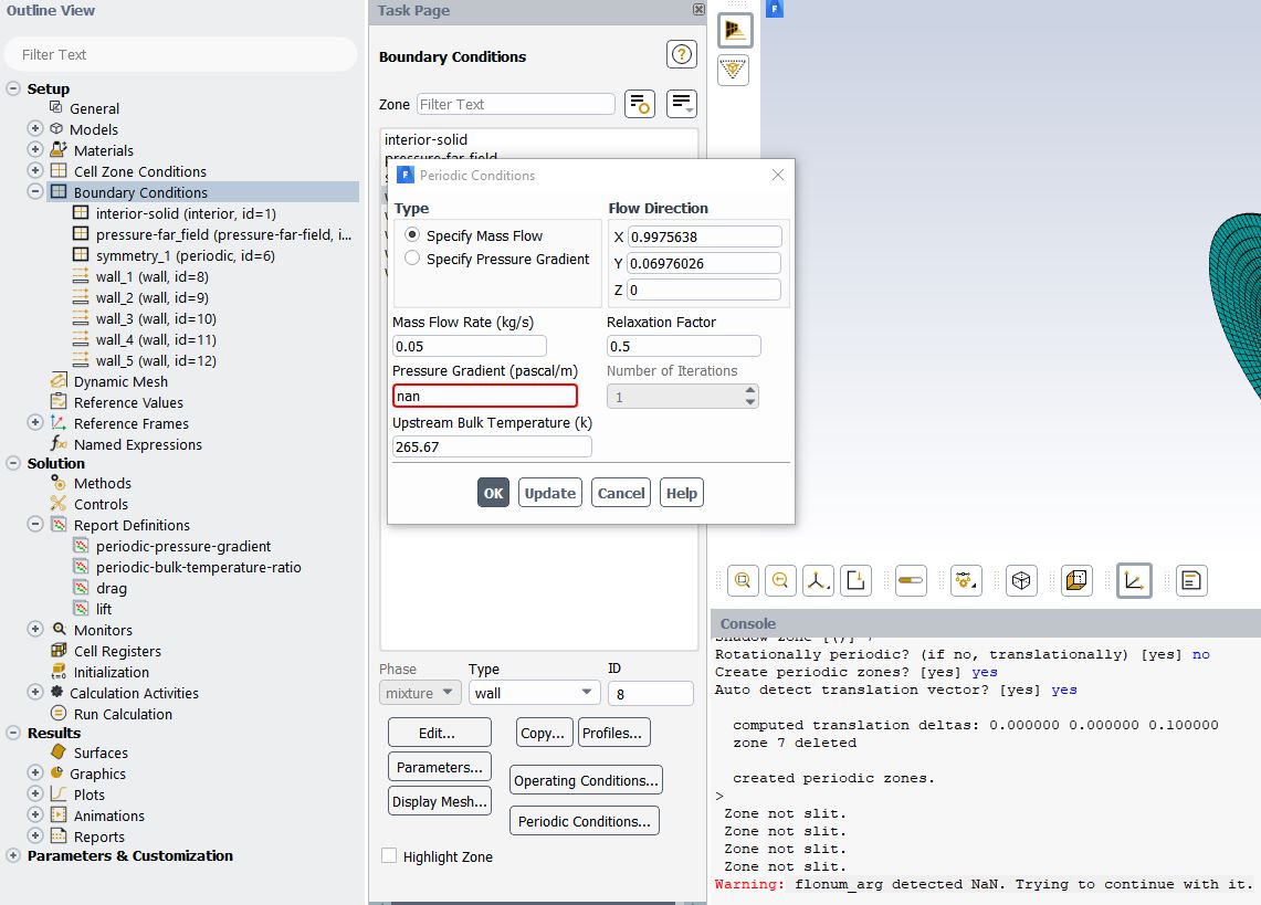

Forum ModeratorCheck the mesh as the last image suggests the jump in cell size could be excessive. Why are you using pressure far field but then pushing flow through perpendicular to the boundary?Â

SubscriberI am using Pressure-far-field because of the application. yes, i also observed the mesh is not sufficient and I have to re-mesh.

SubscriberI don't understand what you mean by pushing flow perpendicular to the boundary?

Forum ModeratorOops, meant perpendicular to the periodic boundary.Â

SubscriberI changed my Mesh and the errors are no more. However, is there any limitation of using periodic boundary conditions in Fluent icing? Because I successfully run the airflow solver but when I tried to run the droplet solver it's constantly giving me error of 999999 mpt_accept failed.

Forum ModeratorPossibly, I've answered in the other thread. I'll lock this one seeing as the problem is resolved.Â
