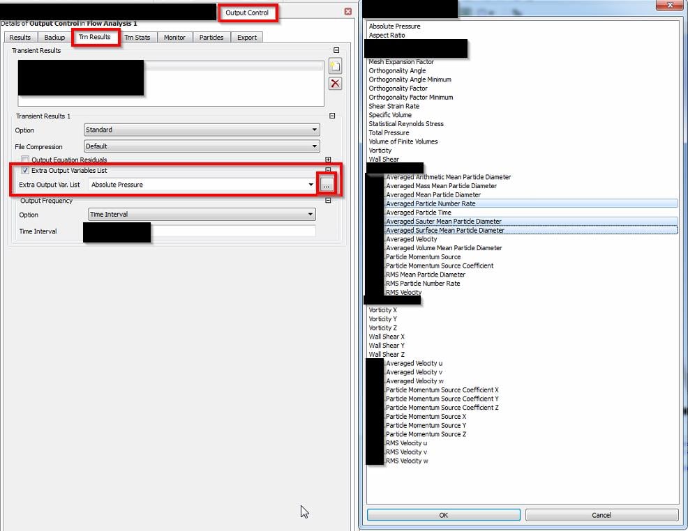

      In CFX-Pre, you output extra variables which are not usually available for CFD-Post. See the image below:
      And as I mentioned in my previous post, particle mass flow variable will not be available in CFD-Post until you activate the Expert Parameter. Enable
      pt force export massflow = t
      in the expert parameters tab and the particle flow variable will be available in CFD-Post.
