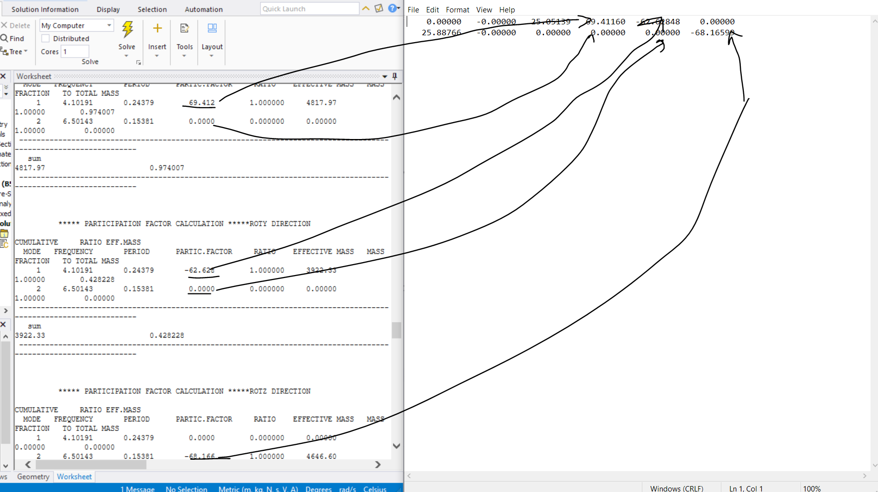

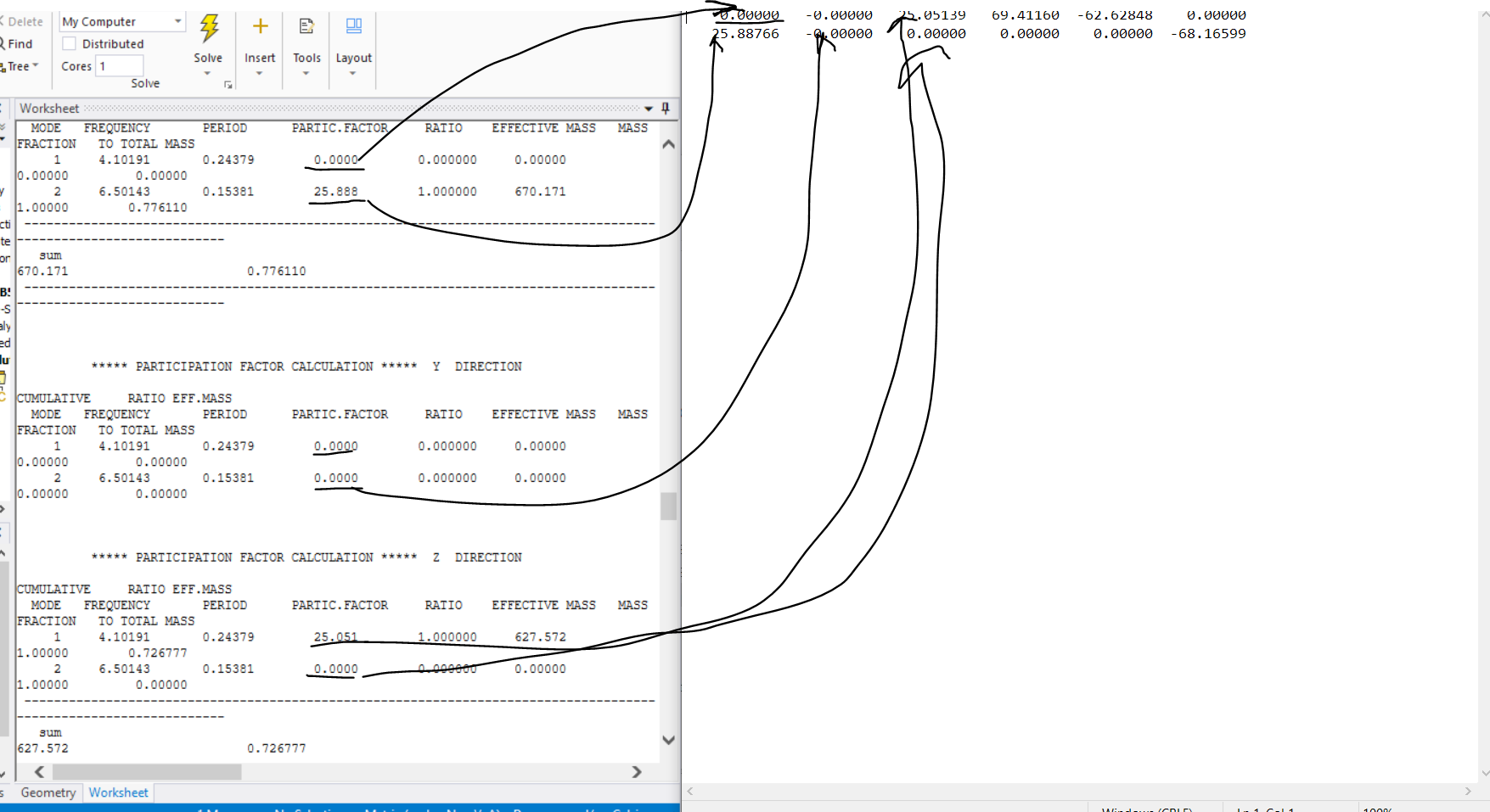

      I'm trying to extract the participation factors of a structure as part of a modal analysis.
      In the commands code, I create an array called "PF" of size [NumberOfModes x 7], which is used to store the frequency values and 6 participation factors (in each direction x,y,z,rotx,...) for all the modes that are needed.
      When I open the results file I see that for all the modes, all the participation factors are stored only for the ROTZ direction regardless of the desired direction (x,y, etc...). The "PF" array contains [NumberOfModes x 1] frequencies, and [NumberOfModes x 6] which all contain the same Participation factors for ROTZ direction copied 6 times in a row.
      How can I fix the problem?

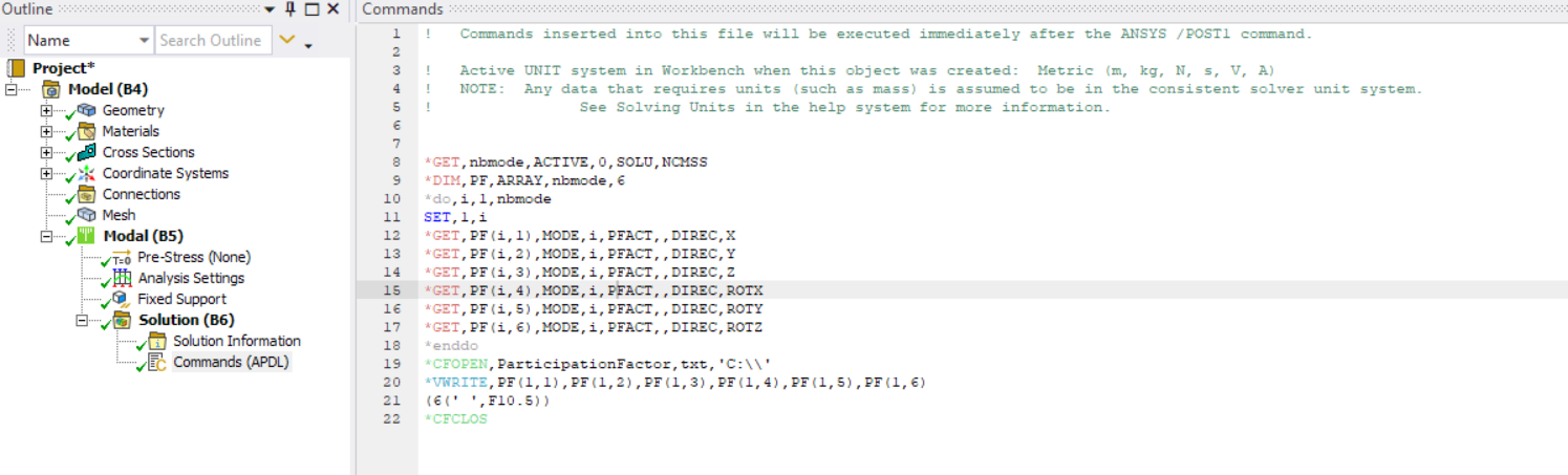

      *CFOPEN,ParticipationFactor,txt,'C:\\'
      *VWRITE,PF(1,1),PF(1,2),PF(1,3),PF(1,4),PF(1,5),PF(1,6)
      (6(' ',F10.5))
      *CFCLOS

      I'm sorry but your proposed code gives exactly the same results. The results contain only the results for ROTZ direction.
      Any other methods to try?

    • ErKo
      That is all the code that is inserted into a command object as shown:
    • SofiK
      It worked once I cleared the generated results and restarted the analysis. I guess the software could not overwrite the results for some reason.
