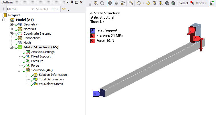

Ansys Employeeugurcavga
In Workbench Mechanical select any object in the loads & boundary condition section. Then choose Tools -> Write Input File. Go ahead and write the file to a folder of your choosing with the dat extension. The format will really be in cdb format so once done you can change the files extension. Â
