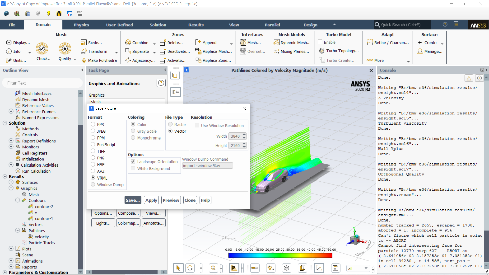

December 3, 2019 at 1:58 pm
Rob
Forum ModeratorIn Fluent we can also export VRML (coloured stl), not sure whether CFD Post and Mechanical support those exports without looking: let us know what you find when you try.Â
