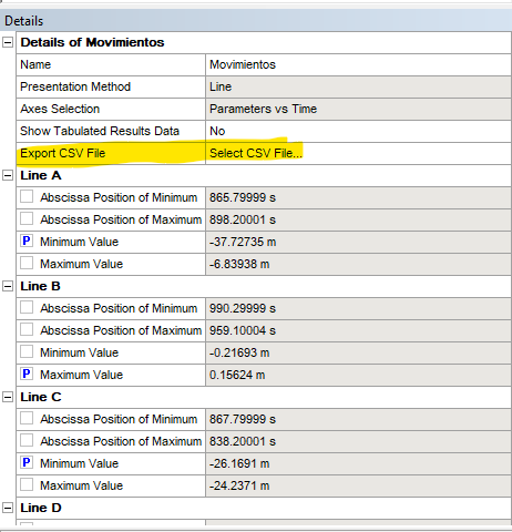

      When input and outputs are set as parameters, and All Design Points are updated, the analysis is repeated for each combination. It is possible to export the results in cvs of all the analyses (design points)? In HD Solution section it is only possible to obtain from the current one.
      Cheers,
      Eugenio
    • Mike Pettit
      Hello Eugenio,
      Please refer to the answer here: AQWA – Export DATA CSV File (ansys.com). The post-solve command to run AqwaReader will be executed for each design point. I'm afraid this is the easiest way to export CSV result files from a parameter study at the moment.
      Alternatively, you can check the Retain option for each design point in the Table of Design Points, and then go into each design point (i.e. Set as Current) and export the CSV result files one-by-one.
