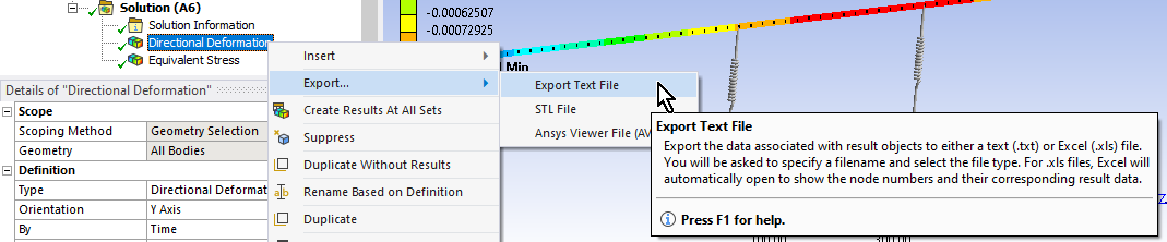

      I would like to ask you how to export nodal displacements from Worbench?
      Best regards
      Michal
      Insert a Directional Deformation result under the Solution. After the analysis is solved, right click on the result and use the Export Text File feature. Note that is only for one direction. Insert two more results for the other two directions.
