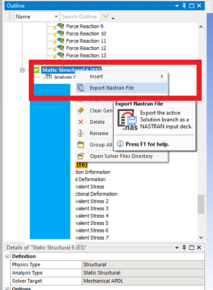

You can follow the process as peteroznewman mentioned. Right-click on the static structural or Model, and then you can export it as a Nastran file.

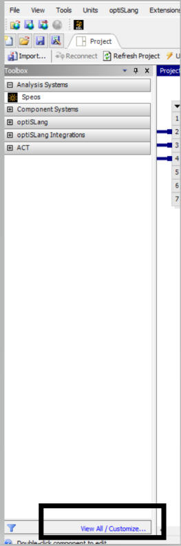

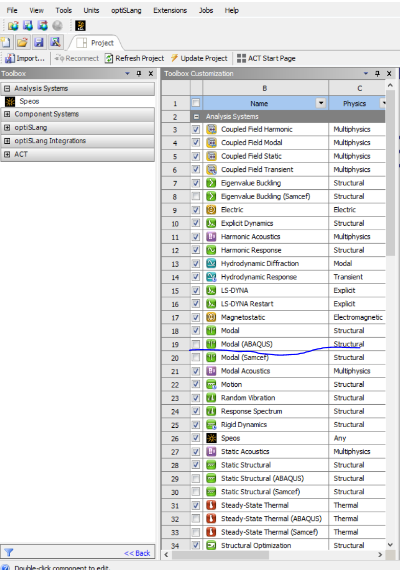

To check whether the Model( Abaqus) available in the student version or not, you can Go to WB and click on “View All/ Customize” and see if the model(Abaqus) static structural ( Abaqus) is marked or not.

SubscriberThis discussion has a screen image of the popup menu to export the Nastran file from a Workbench Static Structrual or Modal analysis.
January 3, 2024 at 2:26 am
peteroznewman
SubscriberAfter you export a Nastran file from Ansys, import that into ABAQUS.

Thank you very much for your reply. I cannot find Modal (ABAQUS) in my ANSYS student version. Additionally, I am attempting to right-click on the solution and export NASTRAN. However, when I click on that option, nothing happens. What should I do to export using that option?
