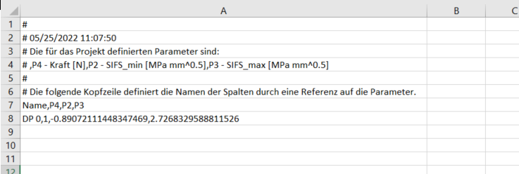

      Hello everyone I tried to export my results with export csv. Data.
      I am using Ansys Workbench.
      But when I open the file in excel everything is writen in one column.
      Do you kow how I can change that?
      I want every result in one cell, like a typically table structure.
      Thank you.

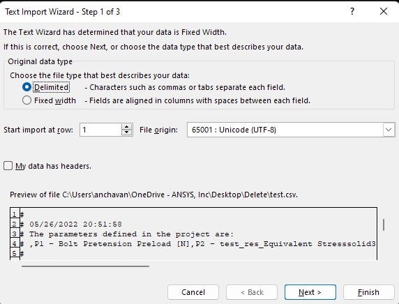

      This is not an issue with Ansys Products per se, but you can close the excel file, and click Excel>File>Open>point to the csv.
      This should open a text import wizard:
      Choose delimited
      Select comma on second stage and click Finish on the 3rd.
      -Aniket
