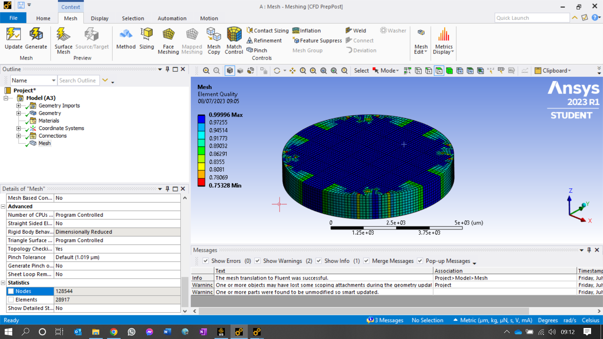

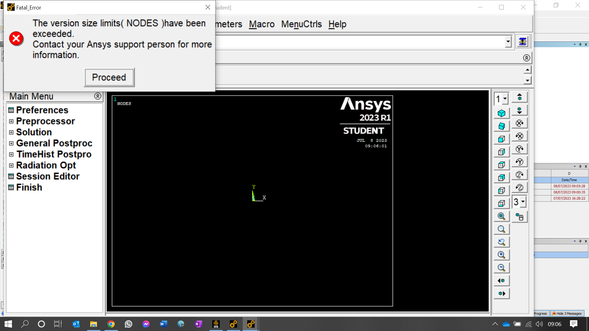

      I am using Ansys WB student version, and looking to export a mesh in .cdb format to import into FEBio for biphasic analysis. However, when opening Mechanical ADPL to perform CDWRITE, I get an error (see attached). Does this mean it will be impossible to export a .cdb file from my current model due to having too many nodes for the student licence? If not, is there any other alternative routes I can take? Unfortunately FEBio is not capable of importing any of the Workbench Export file formats, so a .cdb file is necessary.
