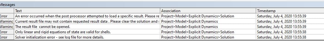

      I'm trying to run a explicit dynamic study of a composite material impact test, but I'm running into issues with it. I've been following this previous post (/forum/forums/topic/running-an-explicit-dynamics-simulation-on-a-composite-plate/) as a guide and have everything (I believe) setup the same way, but keep running into an error that says "Only Linear and rigid equations of state are valid for shells". I'm not sure exactly what I need to fix in order to get it to run.
    • Wenlong
      Which Equation of State are you using in the Engineering Data?
      As the error suggests, don't use nonlinear EOS, such as ideal law of gas, for shell. Pick linear ones, such as bulk or shear modulus.

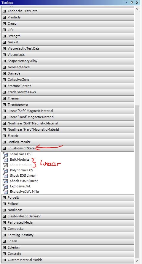

      So in Engineering Data, select "Equation of State" to the left. There you can see options like "Ideal gas law", etc, in which bulk modulus and shear modulus are linear and can be used for shell.

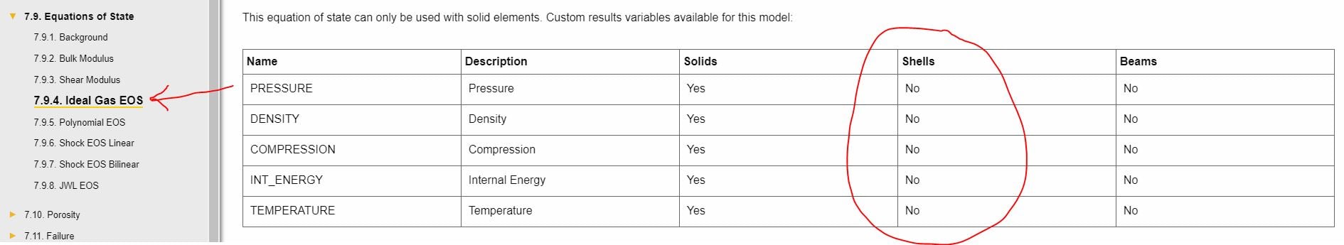

      For more information about EOS, you can refer to this page and its following pages in the Ansys Online Help: https://ansyshelp.ansys.com/account/secured?returnurl=/Views/Secured/corp/v201/en/exd_ag/ds_ex_mat_bkgrd.html.
      You can also see in the following pages that some EOS cannot be used for shell (https://ansyshelp.ansys.com/account/secured?returnurl=/Views/Secured/corp/v201/en/exd_ag/ds_ex_mat_idealgas.html)

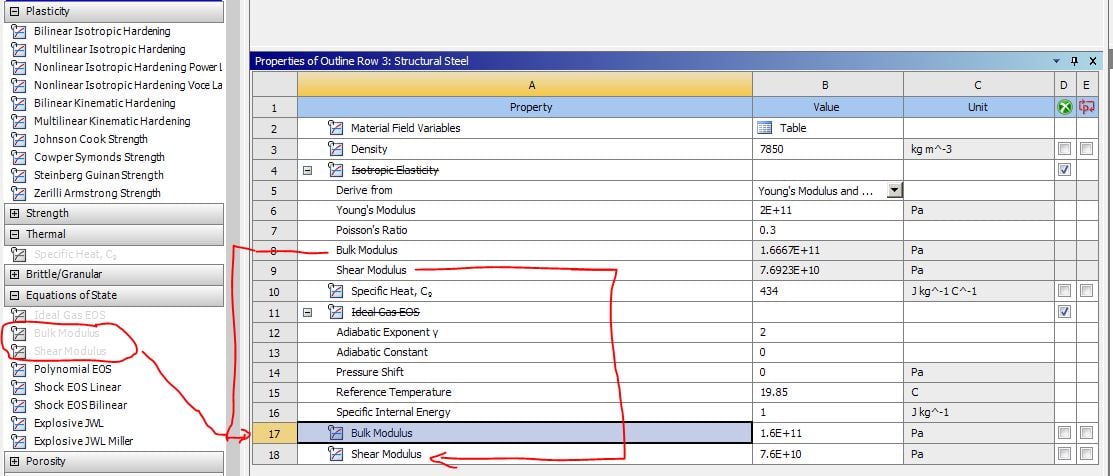

      You probably only defined shear modulus without bulk modulus. You need to define both to make your material model complete. In fact, defining shear and bulk modulus from EOS is equivalent to defining isotropic elasticity, as shown below.

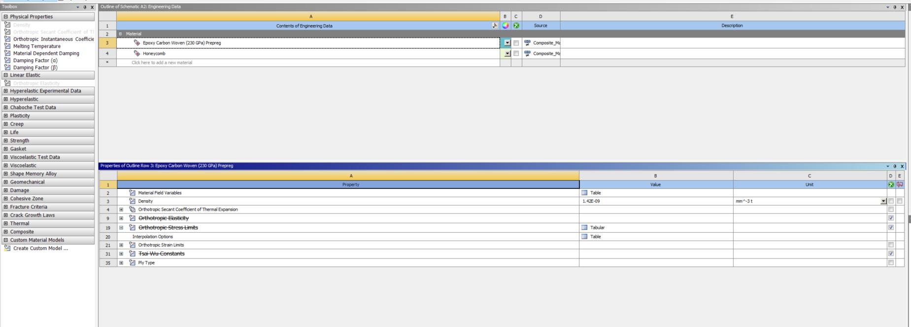

      I am now getting an error saying that the Prepreg requires a stiffness properties, either isotropic elasticity or an equation of state. But this doesn't make sense to me as carbon fiber is an an-isotropic material.
      Do you have any suggestion on how to fix this? I've attached an image of my current carbon materials.

      I have done so, but when running it again it has the original error of "Only Linear and Rigid Equations of state are valid for shells".

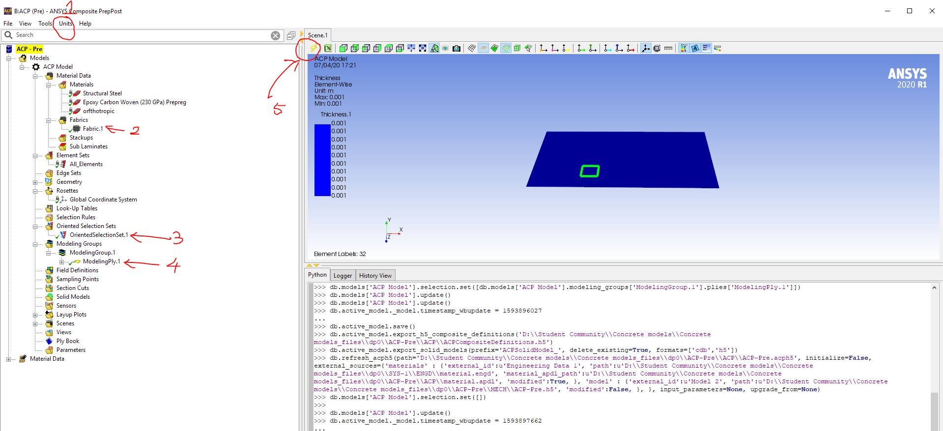

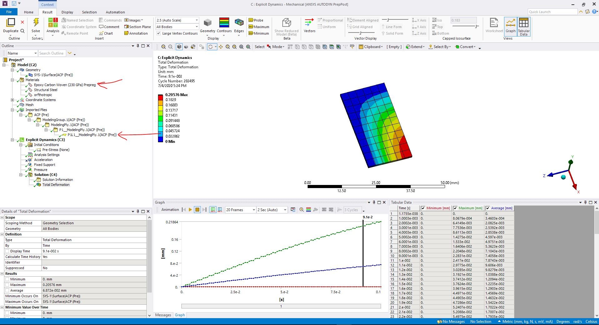

      I see. Then please try to assign orthotopic material through ACP(Pre). In this way, you can first create a composite ply then import the ply into Explicit Dynamics. If you are not familiar with ACP, below is an image about the steps (things you need to define) in ACP (Pre), you can right click on each item and insert stuff.

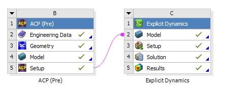

      After you define a laminate in ACP, you can export the shell to Explicit Dynamics, like shown below:
      Sorry I didn't realize you are trying to define an orthotopic material before. It occurred to me as well that orthotopic material doesn't work directly in Explicit for shell but through ACP it works. The benefit of ACP is you can define exactly the orientation of the material direction, and even multiply plies to create a composite (in my example I only created one layer of ply).
      I also found others facing the same issue, please see this post and jj77's reply:/forum/forums/topic/explicit-dynamics-87/
